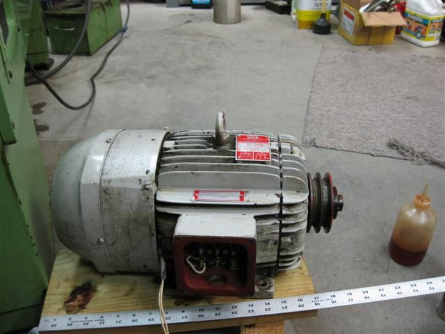

    Update on the condition of the Nardini. There is no continuity through the brake release solenoid witch is integral with the Motor. That is the two white wires shown here:

    Not much help here when it comes to motor internals. If it was mine, I'd haul it to a rewind shop and ask for help.
      So have you popped the back cover off the brake and disabled it for a test run yet?
        For sure, my first move would be to remove covers and verify that the problem is, or is not, actually in the coil, as opposed to connections, etc.
        Then, if it is the coil, an assessment of repair costs, and of the need for the brake (need, not preference) is in order. if you can get by without it, "some disassembly is required", and you could be back in business, albeit without the brake.
        1601
          I wouldn't have been able to resist taking that end cover off, not even if a label said "under no circumstances remove this end cover"!
          Phil
            Might be a good time to check the brake too - for new shoes/pads/disks?
              he won't need 'em most likely, it seems to grab quite well now, or we wouldn't be having this conversation
              And, if it is unrepairable coil-wise, ditto.
              1601
                If the coil is toast they aren't difficult to rewind if a new one isn't available,the magnet wire and potting compound is available here-
