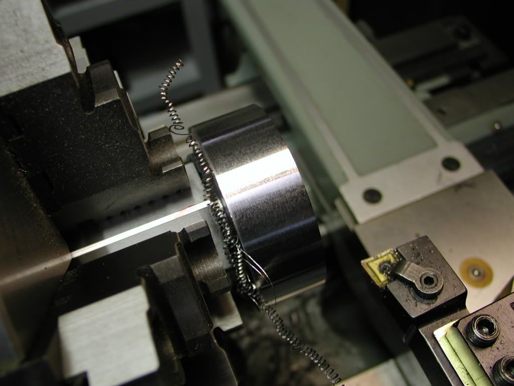

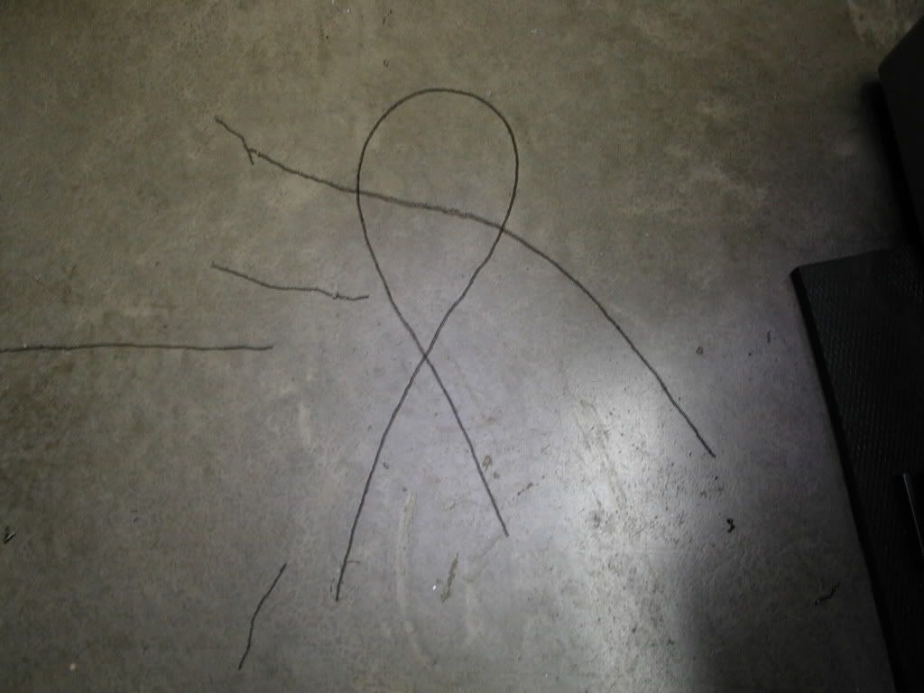

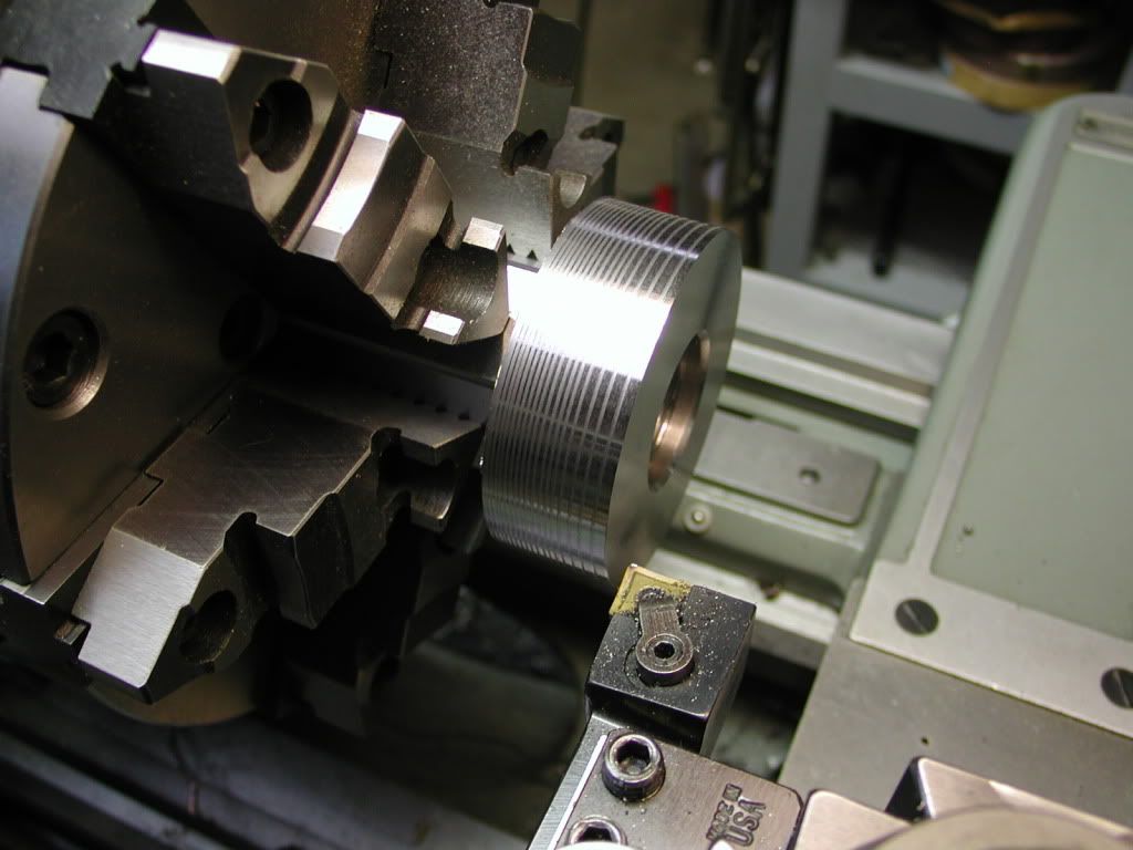

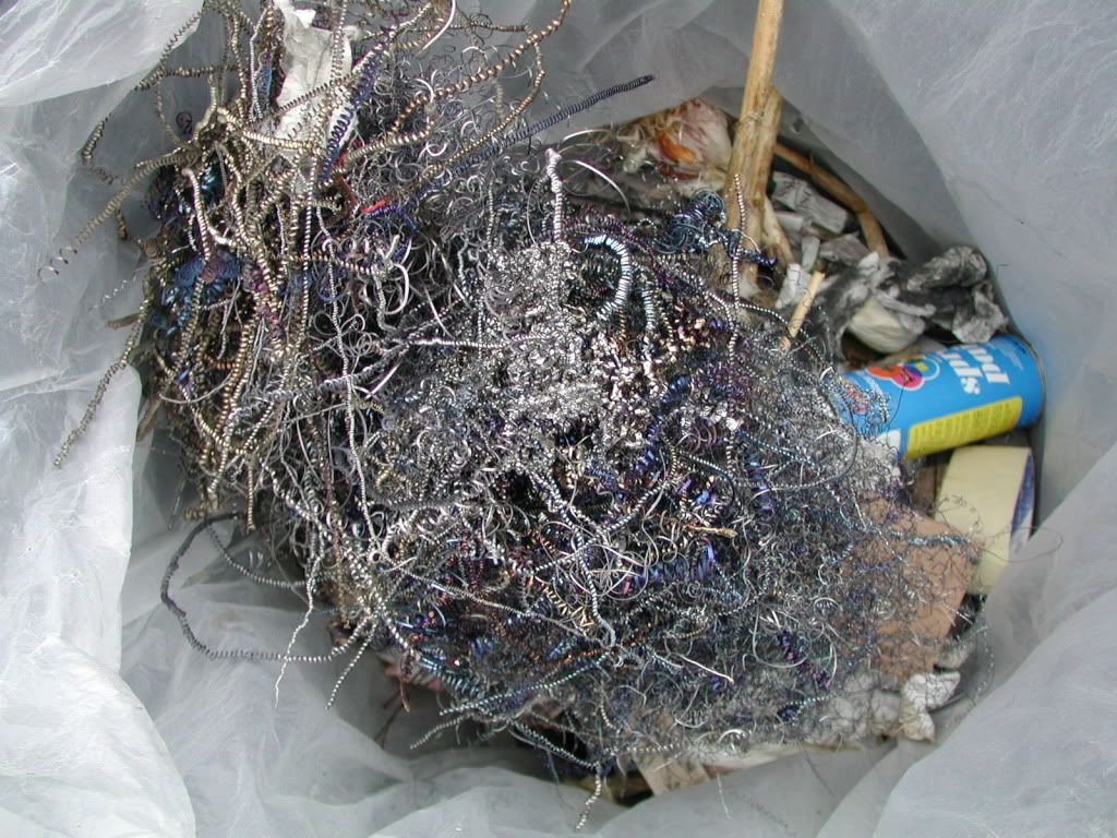

    This has to be one of the worst jobs I've done in quit a while, turning down the flange on the 5C adapter plate. I don't know what the alloy is but it either streams and bird nests or winds springs some being over 5 ft. long. I've tried a few different style inserts all with various combinations of feeds and speeds and get basically the same results. With a .025 or more DOC it get a beautiful finish, the stuff comes off hot and ragged and if it starts to wind around the chuck I have to stop. After a pass I've found that pulling the carriage out fast leaving a slight thread look to the flange seems to minimize the streaming as the interuptions sort of make a breaking point for the stream. I've also found the the insesrt I'm using CNMG 432 does the best job. I could cut a lot deeper but that creates a lot more heat. Perhaps if I had coolant it may keep the swarf cool and brittle enough to curl and break small chips but I don't have coolant. Any suggestions?????? Having to turn off 1.25" on the dia. at .025 DOC chews up the better part of the day.

      I found that a shot of shop air will often direct the curl away from chuck at the beginning of the cut and
      then using a wire L shaped hook to guide the curl to run in a safe direction.
      It doesn't always work, but it's better than allowing the curl to run willy nilly, wherever it wants.

        Increase the DOC to .100-.200", increase your feed to .0065 or higher, increase your SFM to 3-600 SFM. You may have to play with the numbers, depending on your machine size and HP.
        The pull back marks are from spring, and are quite normal. You should be able to get rid of them by repeating the cut without changing anything else.

                        If it does not chip ADD more feed . Keep adding feed until it does.That is the trick.
                          Lots of good points and tips, etc. The insert is a Kennametal KC 730......... dead sharp, not a honed edge.
                          I don't think it's work hardening as I've drilled these with out a problem, it's just tough stuff. I'll see if I can come up with something to clamp down over the insert so the stream hits a wall and possible breaks. What would happen if these were being turned in a CNC enclosure. One couldn't have to keep stoping to weed it out.

                            As Lane says high feed , bags of revs etc, remember they are using 25 HP spindle motors for a reason.
                            modern tooling is designed for this not us lot gnawing and chewing in a home shop
                              I second what Lane said. Also up the speed until the chips are at least straw color. I really prefer them to be blue. I use an NS 730 ceramic from the Carbide Depot. If the KC 730 is a ceramic it works better as you turn it faster.
