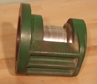

    These three pictures show the drive pulley assembly for a woodworking shaper. Two #6210 ball bearings are pressed onto the aluminum pulley, then pressed into the cast iron housing. They are restrained at the bottom of the housing by a shoulder and at the top by a snap ring (not shown). In operation, the pulley turns at about 7000 rpm
    Problem is, the bearings are loose in the housing bores. Indeed, I can get a .002 feeler between the outside of the bearings and the housing bores.
    So, what are my options to tighten everything back up to a tight enough fit that the bearings (one new, one old) won't spin in the housing?
    ps. It occurred to me just now as I was writing this that the bores in the housing may be worn out of round and off center, toward the motor side because of the belt tension. I'll have to check that tomorrow.
    If it's out of round, bore it and press in a sleeve.
    If it's not out of round, that should be the proper clearance for a drop or two of Loctite bearing retainer compound.
      If it's only a .002 gap, wouldn't Loctite fill the void?
        The "right" way is to bore, press in a sleeve and bore again. However... if the existing bore isn't too bad you can lightly knurl the bore and press the bearing in. Even "pricking" the bore with a fine punch in many locations can suffice. All depends on how critical the application is.

          Housing needs to be bored and bushed and if the shaft is worn...turn down approx 0.050" or so under/
          machine up a new sleeve with a 0.002 to 0.003" tight bore...heat up ...shrink fit on.
          Leave the od +0.100" . wait to cool...machine to new bearing bore fit...see below chart for proper
          sizes for your bearing

            Ball bearing shim rings,made to fit the bearing.In use the housing is bored to the bearing OD plus 2x's the shim thickness,the shim is inserted into the housing bore and then the bearing pressed in.

                    No doubt the bush idea is the best. Bit it will involve fixturing the housing while leaving both bores clear, and line boring the two together to fit the bearings, then putting in the snap ring grooves. It appears you have holes and a surface to use as attachment and reference, so it's possible to do without too much trouble.
                    Or, you could loctite them as several have suggested... The bearing seat locktite is not a "stud retainer" type, so as mentioned you shouldn't be needing a torch if you ever need to remove the bearings....

                              Having a .002 clearance is no problem. I would sooner have that, then a mis-bored housing !
                              First, the suggestions to use locktite bearing mount are superb !
                              If you work with high speed precision spindles you will find that rather than encounter ball bearins with mis-alligned housing bores, They over-size the bearing mounting bores a few thou and then loctite the bearings when the spindle shaft is installed. The bearings run much cooler, as they are installed without any "housing preload". They also are quieter , again, because the balls were not compressed in any manner , but instead are in a free state.
                              Since this is a high speed unit, go for the Loctite bearing Mount.
