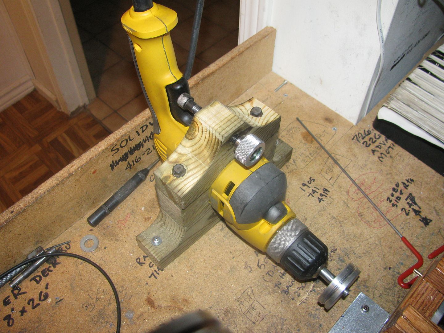

    This is definitly not rocket science---BUT--If, like me you occasionally need a variable speed rotary power source, don't overlook your common 3/8" variable speed drill. A couple of pieces of wood screwed together with a drill body size cut-out between them, and a threaded rod or long bolt (tap the hole in the wood to suit). I even added a fancy knurled knob to mine, simply because I already had it left over from another project. It works great!!! Screw the threaded rod in or out against the drill trigger, and you can turn the drill off or turn it on and screw the bolt in until you reach the speed range you desire. Most of these drills have a reverse as well. This is probably the lowest tech tip you will see this year.---Brian

        I've been using electric drills as power sources for years, but there is simply no good way to hold the damn things. The other night I decided to make something that was quick, cheap, and re-usable, and that could be screwed down to a base for use with o-ring drive belts to drive model machinery. This seems to fill the bill very nicely.
          Nice solution Brian, i can see where the odd time that would be a handy jig/bracket to have around.

                Nice idea about using the wood to prevent crushing the frame, note that lots of those drills use the plastic frame as the housing for the motor and gearbox/everything, so crushing it could easily cause things to start rubbing/binding.
