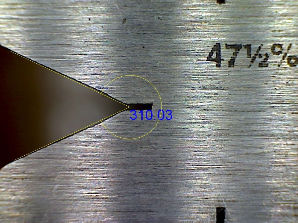

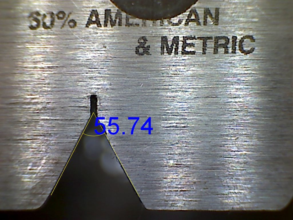

    A very basic measuring tool but how did they get it so wrong?
    Their quality control is certainly off by a few percent or is that degrees?
    Even without measuring the angles, that gauge looks really bad. What about the 55% marking and the hole punched through the printing, which looks like very cheap screened text. I would not discount the possibility that they have gone way down market with the cheapest possible Chinese outsourced gauge, but it is also possible that the whole thing is just a cheap copy.

        Why are they using % when they should be using degrees? Very sloppy item whether UK or China made.

            Quite possibly a counterfeit.
              It got flipped around for printing, but that 47.5 degrees is still of based on your measurement.
                exactly what I was thinking

                        what equipment / program did you use to measure those angles
                        all the best.markj
                          Looks to me that it was marked on the "back". That's still no excuse for the errors in angles.
                            Its not just the errors in angles; the text itself is incorrect. That is not a one-off error, the whole batch will be using the same incorrect screen printed text. Incidentally, I have checked pre-ground HSS screwcutting tools on a toolmakers microscope before. They were out by at least half a degree, not symetrically, which I would consider unacceptable. The combination of that faulty gauge and those faulty tools means that screw threads could be badly out.
