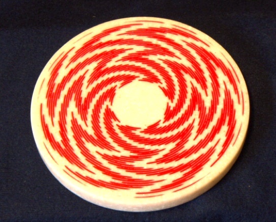

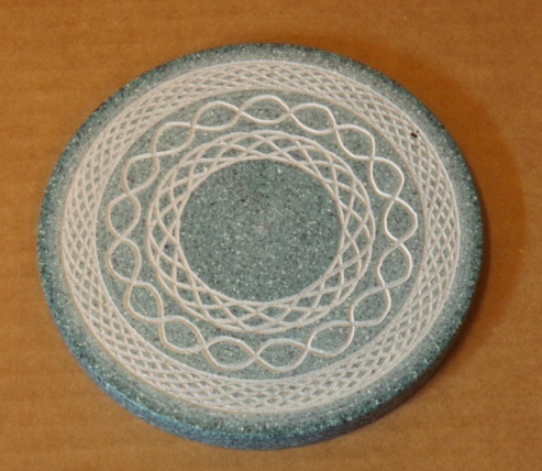

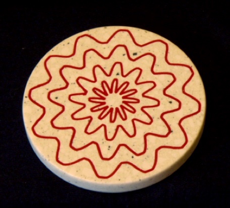

    A few more pix:
    The outside ring here is 17 repeats in 10 revolutions. The middle ring is 17 in 2. The inner ring is 17 in 5.
    Using hole plates from an indexing head, I can create spiral patterns.
    Another spiral.
    A series of 12 / 1 patterns, with the cutter about 1/16" or so above center.
