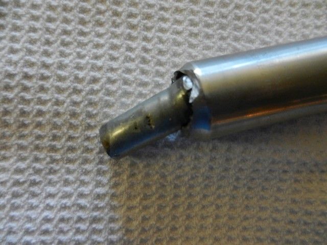

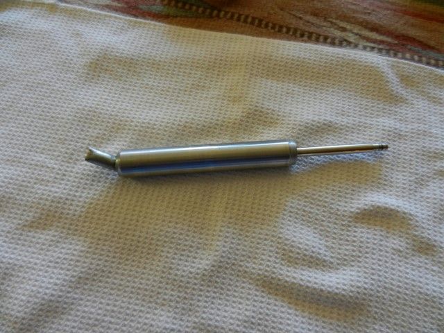

    I have this cylinder from a desk chair. It clearly states not to cut on it or heat it in three different Languages.
    I was thinking about putting it in the mill and drilling .063 hole to vent the gas then cut it open on the lathe. I would appreciate any advice.

        Why do you want to open it? I would proceed with caution, there is High pressure involved. Something in the 600 psi range depending on the dia and length. It could spit out oil or chips at a high speed. The cautions are there for a reason. Mostly for lawyers. Bob.
          What I've done is to start a hole with a small drill bit, 063 is fine, then clamp the tube in a vise using the part that you will throw away later- one end usually. Then get a rag around the drill bit and around the tube and carefully drill until the gas begins to escape. There's going to be oil squirting out with it, to some degree at least. Of course you have to be careful that the rag doesn't catch and wrap up with the drill. A cordless would be a good choice, or at least variable speed. I haven't had any problems with the rag winding up, but why not just be careful-
          Anyway, once the gas begins to escape, wait for it to finish and then finish drilling the hole. From here it's a matter of keeping the fluid from getting all over the place. You might drill a second hole at the other end of the tube, maybe on the other side, and have a pan under it somehow to catch all the fluid. Have lots of rags handy- it can be a mess. I usually collect the fluid and store it in old pop bottles. I don't know if I'll ever use it for anything, but it's keeping it out of the environment for now anyway.

                    The end goal is to repair the chair. I would like to salvage most of this and I would like to know how it is constructed. The linear movement is not important to me. I think the end that is broken is actually a ball joint and provides part of the tilt motion to the chair. This is 1 1/8 dia. X 6" long so there is not enough volume to contain much gas or oil.

                        Be sure and protect yourself against breathing the spray that comes out. The bandsaw seems the best idea to me, it mounted in vice, and as soon as the saw cuts enough for pressure to start relieving, you have the power cord in hand and unplug to stop it cutting.

                          Not sure if this would work, but what if you got a piece of PVC or steel pipe slightly larger than the OD of the gas strut, drill a small hole in it first, slide the strut inside and drill into the strut through the predrilled hole in the PVC pipe. If and gas, oil, spray or shrapnel go flying they would be trapped in the PVC pipe and only allowed to come out of the ends as the drill b it would be plugging 90% of the hole in the PVC or steel pipe. Rags could be placed at the ends to absorb anything coming out.
                            Hey Byron. I dont think you will get much excitement from it. Like the others have said there might be some oil. I wouldn't expect much. The chair small gas filled shocks are more of a sealed unit to control movement as opposed to some heavily charged shocks that require some heavy duty damping.
                            Id even go at it with a hand powered hack saw so you could keep a shop rag over the cut while cutting. Once the tube is pierced it will vent the gas and whatever oil into the rag and then you could preform any additional tear down that you want.

                              Be carefull tried that cut one from chair no oil but when the end came off sounded like a gun shot and left a large dent in the wall!
