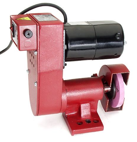

    I am considering buying a toolpost grinder for my lathe from Little Machine Shop.
    http://littlemachineshop.com/product...2001&category=
    I simply don't have the ability to turn small precision parts like needle valves for miniature carburetors on my 10" x 18" lathe. Once I get below about 3/32" diameter stock, the material just flexes away from even my sharpest HSS tooling. I am assuming that with a toolpost grinder like the one shown in the picture and link, that I could grind these small items to the required taper. I would be using this for unhardened mild cold rolled steel. I would also use it to grind the sealing faces on miniature valves like the ones on the small i.c. engines I build. I don't know the first thing about toolpost grinders, but for $150 I am willing to learn, especially if I can use one to make these small parts that I have no other good way of making. The one in the picture is 2" from the center of the grinding wheel to the base, and they suggest removing the compound rest and bolting it directly to the cross slide table. My lathe measures about 3" from the center of the chuck to the top of the cross slide table, so I realize I would have to machine an adapter plate. Of course, this would leave me with no way to set up angles to grind tapers, so I would probably have to have an adapter plate with drilled and tapped holes at whatever angles I would most commonly wish to grind on tapered needle valves. Any insight that you can give me in respect to what i want to do would be much appreciated.-----Brian
    I have one like in the picture. It is okay at best (or I wasn't in the mood to fuss with it) I would suspect you could do what you have described with a "pencil grinder" held in a block on your compound. This would give you the angle capabilities you are looking for as well as a finishing tool when removed from the block. You want to mount the grinder so the part are "fighting" each other not so they are "helping" each other.
      I'm looking at this wondering if you could turn the base 90 degrees so it's facing backwards, then mount it to an angle plate, thereby getting it low enough to sit on the compound. You would probably have to cut off the front foot too. Then you would be able to do all the angles you want with no restrictions. Maybe that would work, maybe not.

              Can't be much of a tool post grinder at that price. The bearings in real one will cost more than that. It has no ID spindle and no provision for speed change. The wheels Are likely crap as they give only the grit size (60 and 80) which are too fine for that kind of work.
              A tool post grinder does not a grinding machine make. The mini lathes that it intended for are POS. A ground finish won't change that.

                  Brian, that little grinder will I am sure have some basic functionality so if it was me I would buy it and see what it could do. They are not very expensive in this country and I assume in yours too, probably cheaper than here.
                      I'm not convinced the grinder is the answer and would also have concerns about the quality - you might just being buying more frustrations. Work will still bounce away from a grinding wheel to some degree and super cheap spindles won't give a very good finish

                      I'm taking this to mean you somehow dress the wheel, then angle the TPG, pin in place and present to the work at an angle to get your taper? I see that as a big challenge. First your trying t grind the full width of the wheel which will really make the work bounce away - sort of anti solution if the problem is the work is so small and flexible. Secondly, you want the wheel moving over the work for a good finish, not just plunged in one position
                      I would either turn it using suggestions above or trying rigging up a foredom or something with a small wheel. The foredom gives a reasonable good little spindle, if you have to buy its got a 1000 other uses (vs a low end tpg), it'll be small enough to mount on the compound so you can use it to cut the taper and the tiny wheels will minimize the force on the flexible work. but first i'd try turning it

                            I started off with a cheap grinder mounted on the cross slide, but I didn't get the results I wanted.
                            So I made this out of it (this was what the leather belt joining q was for). The grinder drives a real grinding spindle at about 10k and mounts into my toolpost and there is a foot pendant on the floor within reach of my foot to turn it off and on easy. I'm happy with the results from it.
