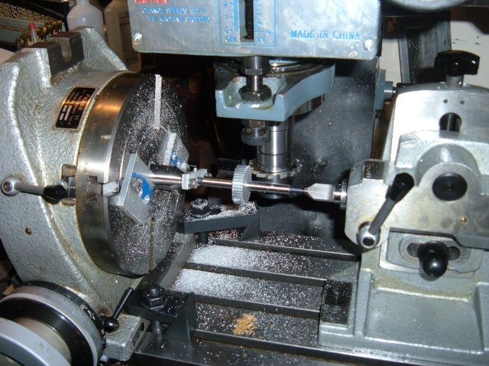

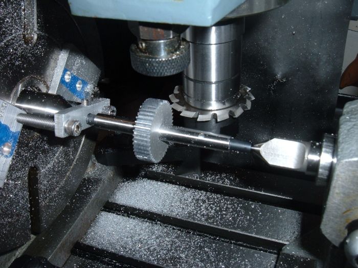

    I cut my first spur gear today. A 32 DP 45 tooth .375 inch face spur gear. I would like to thank Marv Klotz for his utilities, Brian Rupnow for his help, and the rest of the forum for their gear/hob/cutter posts, all of which proved helpful. Images below (otherwise it didn't happen).
    My setup:
    Closeup:
    Final Result:

          Nice - and congratulation to you. But here is some good advise for future production.
          It looks to me like you pushed a gear blank onto a tapered mandrel. If so, you are lucky the blank did not turn on you. That happens when the cutter pushes just a little bit one way or the other. Could be the sharpening or even run-out.
          Next time make a mandrel with a shoulder and a threaded part in front. Than tighten the blank on the mandrel using a nut. This will make sure there is no movement.
          Many times you don't even know the gear has moved. You can not see the difference on the tooth. But you will hear it once you assemble and run it. Happy gear cutting!

                I hadn't heard this before, although use with a AL gear would give some pause is the soft material might deform. AFAIK, pressing a mandrel into a gear blank is fairly textbook as is working between centres, isn't it?
                  Looks good to me too. I would also be concerned with possible movement on the mandrel. I agree with Juergen's suggestion.

                      Cutting gears is enjoyable, cutting one that is the correct size is even more fun. The gear in the photo looks great. As to the means to hold them while cutting, the tapered arbor is worrisome as the smallest rotary movement and the gear is junk.
                      My personal preference is a stub arbor with either a screw or nut applying the clamping pressure. If possible I use a woodruff key to prevent rotary motion between the blank and the arbor. If the gear blank has a setscrew use that as well.
                      Sometimes a belt and suspenders are a good combination and if that isn't enough there is duct tape and super glue.

                          Cutting a gear by pressing the blank onto a mandrel is NOT the preferred method. However it will work fine if you are very careful and have a sharp cutter. The problem gets bigger if you have a larger dia. blank with a small dia. hole. That is why you have to make sure your blank can not move while being cut. Best of course is a blank with a hole having a key slot and a mandrel having a key. Set screw if you have a blank with a shoulder. The mandrel with a key requires a little more work. So the easiest thing to do is making a mandrel with a shoulder (the larger -the better) and a partially threaded front so you can tighten the blank against the shoulder using a nut. Centers on both sides are best but one could get away with using a chuck or a collet on the dividing head side. Use an indicator to make sure your mandrel is running true. Why take a chance and end up with a half of a tooth at the end. Bummer! Also make sure that you take out any play when advancing your dividing head spindle.
                          Another tip: If your mandrel is to long or to thin like is the case with MinnesotaHSM set up, and you are cutting a steel blank - the mandrel will be flexing on every turn your cutter makes - guarantied! Milling machine arbors do not run true and your cutter will be pushing down with every turn. At the end of the cut, when the cutter starts coming out of the blank, the cut will get slightly deeper. You will see it on your blank. That is why some people prefer to have enough material at the end of the cut so the cutter will always cut the full depth. You can turn it to size later. Next: always stop your cutter after finishing your cut before you crank back the table. Otherwise you end up with cutter marks on your blank.
                          Cutting gears can be fun and also a challenge. Lot of info in your MHB. You learn something new every time you make a gear. Happy cutting MinnesotaHSM. Juergen
                          Ps.: If you use a set screw be sure to check the blank for run-out after you tighten the set screw. They have a way of sometimes moving the blank or the mandrel.
