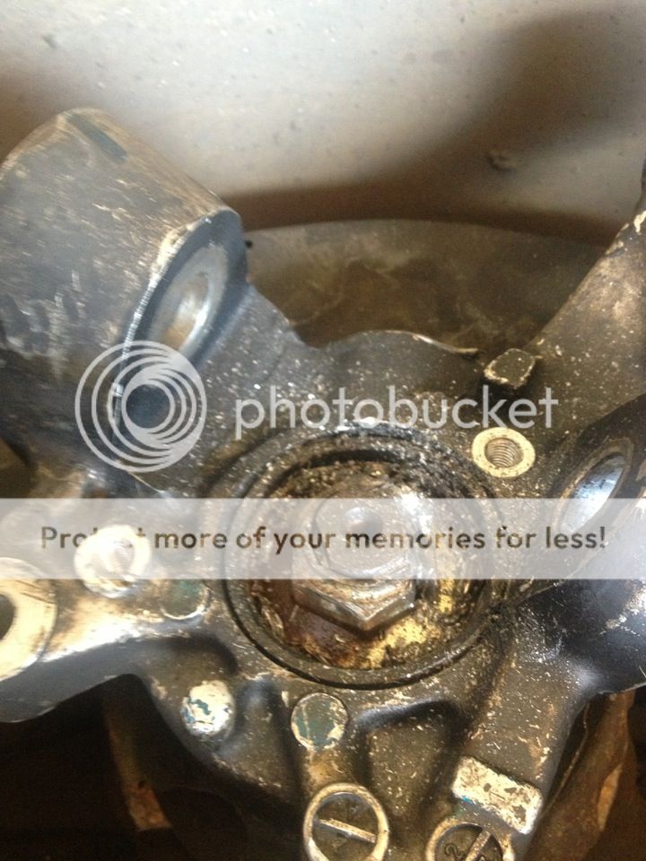

    I know jack about cars. My pal has had a wheel bearing fail in a 300XZ I believe. He can't get the nut off the axle. I don't know any of the right words, sorry. Here's a picture if it works from Facebook. He's started trying to remove the nut forcibly so it's probably too late for the Right Way.
    But why won't this nut budge? There were two flats on the axle. I am surmising there's a locking device in there somehow.

            looks like die grinder and double cut carbide burr time to me. take out the majority of two sides of the nut, without taking too many threads off the shaft. nut is toast anyway, and the axel threads can be cleaned up to work fine. . . . . and of course safety glasses and gloves. . . . those burrs are nasty things to work with.
              I think the rim of the nut is usually hammered into the two flats as an anti rotation feature. Once you hammer them straight with a chisel you can put a socket on it. But the left hand thread is a possibility.

                Looks like a standard lock nut to me, air impact should have removed it without difficulty. Too late for that now. Like Davidh mentioned all you can do now is hope to save the axle.
                You will also be needing a press in order to remove the bearing from the steering knuckle.

                  But from what I see there is no saving the hub either, looks like the threads are all gone on it as well. Just have to pull it out of the bearing and get a new or used hub and nut.
                  When I come across a stuck nut on axles or hubs like this I will cut a line in on side of the nut and use a punch and hammer to split the nut on the one side and then get it turning off.
                  Also like mentioned it could have been right/left hand threads.
                    I have seen axle nuts on some cars that will fight a 1/2" impact wrench all the way off. These were not rusted either. I have seen some loctited and lock nuts. May not be in this case though.
                      Looks like a replacement hub, bearing, shaft, and nut to me. This is where the Japanese get their revenge, my friend.
