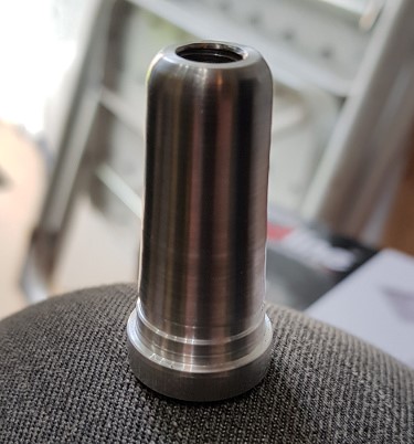

                    • Started tidying and reorganising my workshop in the futile search for more space. Naturally I got sidetracked by some minor detail and ended up machining what looks like an aluminium suppository!
                      I have an 18V angle grinder that comes in a storage case. In the blow-mould plastic liner, they provide a spindle to store your spare grinding discs. That's great until you pick the case up and they fall everywhere. This part goes in the back of the spindle to reinforce it and then takes an M8 threaded rod with a washer and a wing nut on the top to retain the discs. M8's massively overkill....but that's what I had lying about. The part looks fairly straight in the picture but it tapers by about 5mm. Nose dimension and tail dimension (just before the last shoulder) are accurate and the middle is just tapered by slowly unwinding the cross slide as the carriage power fed. The groove before the shoulder is a necessary precision feature.....and not at all a result of knocking the lever from power feed to cross feed accidentally *cough*
