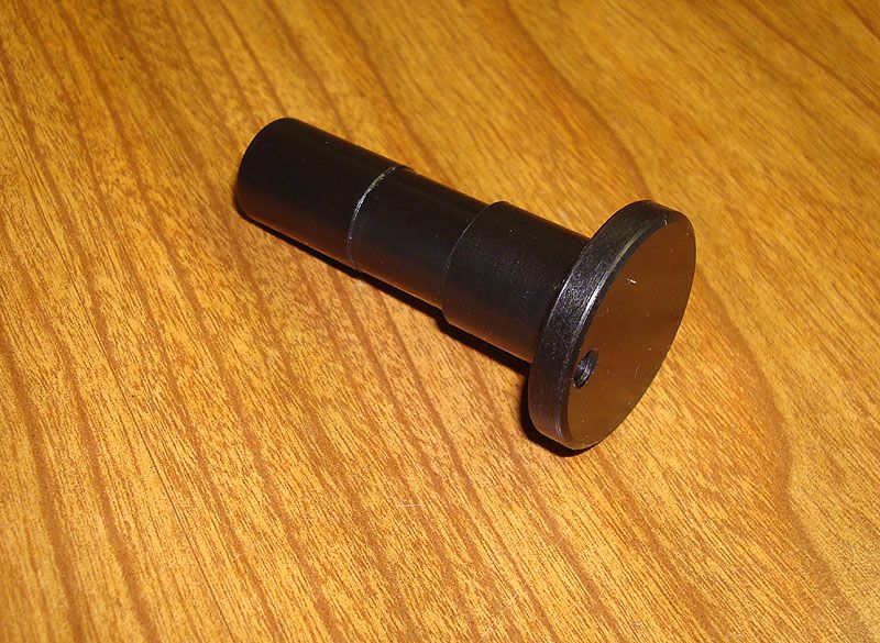

                Tailstock ram Anti-rotation keys
                Both my lathes (Standard Modern 1120 and Myford ML7) were born in 1968 and over the years I've repaired/replaced a few worn parts.
                One that has been bugging me for a while were the anti-rotation keys in the tailstocks of both lathes. The wear allowed the ram (barrel/spindle) to rotate a bit and sometimes, when drilling, an oscillation would occur.
                The old ones are shown in the photo and the one on the left is from the bigger lathe and the disc section, which runs in the ram groove, was about 0.005" undersize. The one from the Myford was also undersized in the key section and also about 0.003" undersized in the round section.
                Used 1144 for both replacements and, needless to say, the larger one took me about 4 times longer to make. Most of that was taking many passes to get the width of the disc section just right and meant I had to remove it from the collet each time to measure it.
                The result on both lathes now is no rotational movement so I am a happy camper.

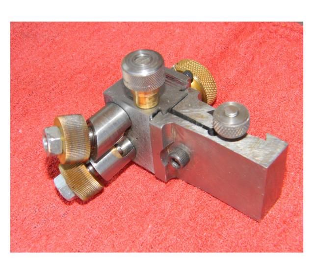

                  Plugging away at a variation of Tom Partington's cut knurler, plans from PM. It's half done now but the evening's still young...
                  Uploaded with ImageShack.us

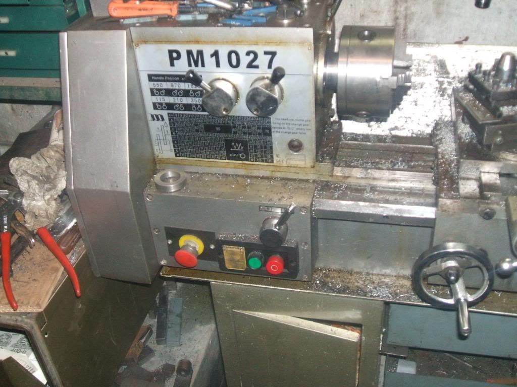

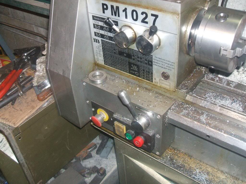

                    Well, I made a replacement handel for my lathe feed screw. Got tired of looking at the "missing plastic knob" and decided to make one (needed something to do while hiding from the MIL lol)
                    After
                    Nothing spectacular, but did keep me occupied

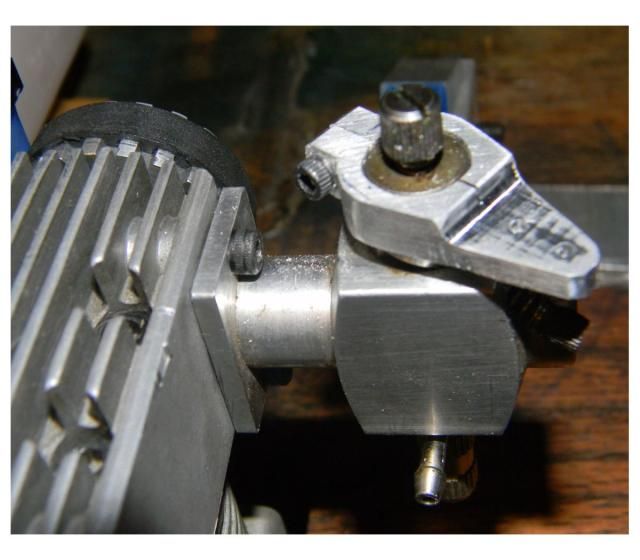

                          I made a vintage looking throttle arm for the carburetor of one of my odd-ball collectible antique engines out of 6061 aluminum and an 8-32 socket head capscrew.

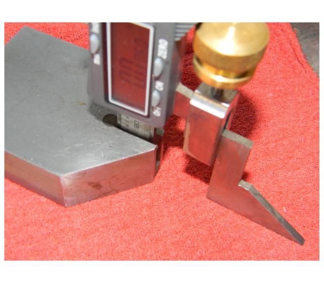

                          I've already got a cut knurler partially completed. (the McGiver version) These photos are of the prototype.
