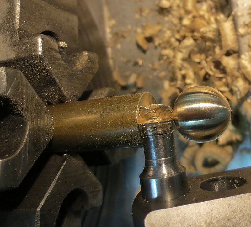

    Starting on the fly-ball governor. Using ball turner made from cheap boring head mounted in tool post turn couple brass balls.
    Brass balls are drilled and tapped. The other connections are either silver brazed or riveted.

                Could you show a few more pictures of the tool used in the boring bar?

                      Boring bar cutter is just a round carbide milling insert silver brazed on end of mild steel rod.
