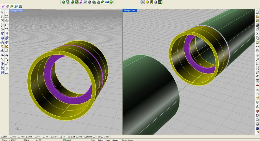

    Looking for some ideas on how to couple two 9" O.D. aluminum telescope tubes together. This is for an 8" f/18 Achromat telescope. I was "thinking" something could be machined out of aluminum, delrin or (something ... dunno) ... to serve as a baffle (the purple/magenta circle in the drawing) properly located of course and "also" to couple the two tubes together? Each 9" tube could slip "over" the baffle coupler sleeve and held in place with screws. I wonder how "long" the slip part of the coupling needs to insert into the tubes. Any ideas?

    The real issue is using plastic. Thermal expansion is bad enough with aluminum but every inch of plastic is about like a foot of aluminum. Then the problem is finding a piece of aluminum in that size. The best bet is to simply slit a piece of the same tubing so it can be closed up enough to fit the ID. Baffles are easy, cut them out of whatever like cardboard or even thin birch plywood. Wood also has the advantage of not holding much heat.

      The only reason I mentioned baffles was to incorporate one inside the coupling (killing two birds with one stone so to speak). I wonder if wood is an option, then turning it to the proper I.D. and maybe put some metal threaded inserts into the wood for fastening.

            Concerning the length of engagement of the coupling, your best bet is to put a shoulder on the insert and butt the ends of the tubes against the shoulder for alignment. Then the tube engagement could be as little as 3/8 inch. If the tubes are aluminum, the coupler might as well be aluminum as well for uniform thermal expansion. If you are not breaking the joint down periodically, then you also might as well assemble with loctite or epoxy. Assembly with screws will give the joint opportunity to work loose over time.
