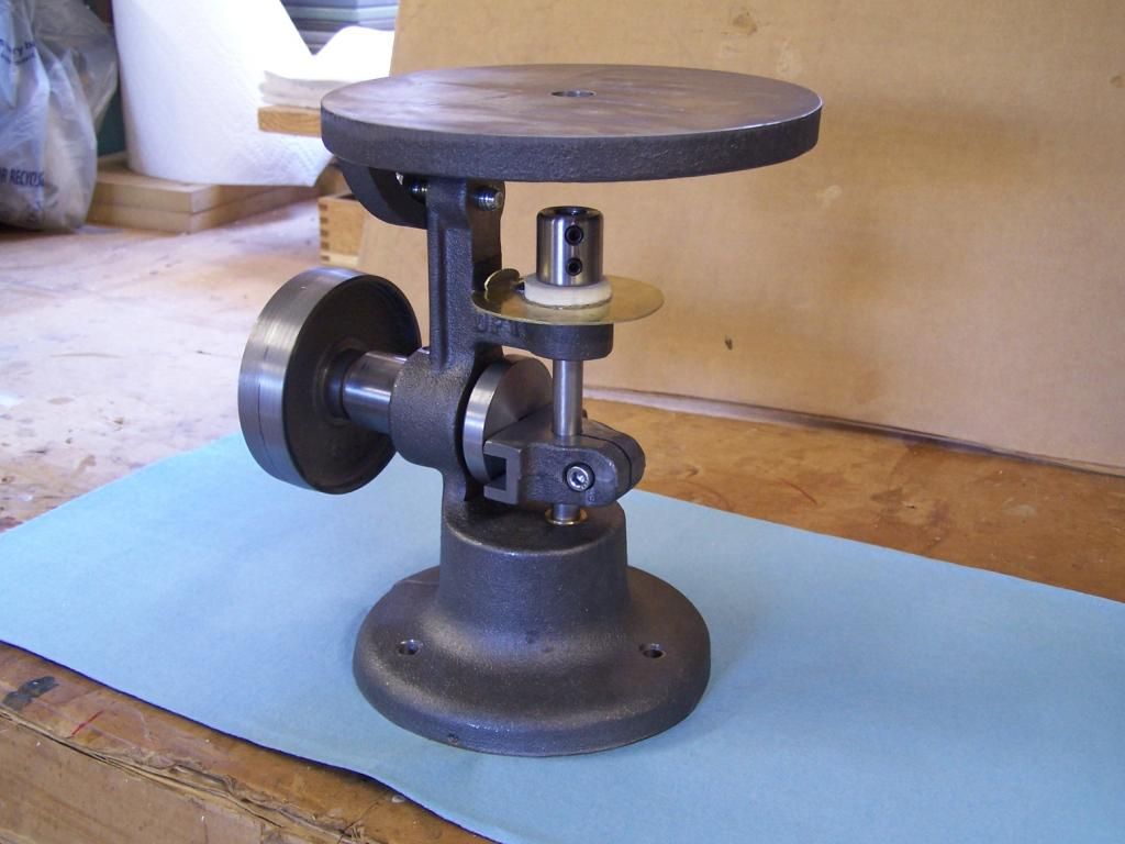

    I have been wanting a die filer for small parts I get involved in making from time to time. I found http://www.martinmodel.com and ordered the casting set he has listed. I have not worked with cast iron prior to this so it was an adventure for sure. It turned out pretty nice altho I did make some changes by adding bronze bushings rather than the iron to steel it calls for. The drawings are good and show all that is needed but I had to do a bunch of different setups to get all the parts machined. Now I need to order files and I am all set.
    Seems like that lower bush could use a felt to keep the particles out of the bearing. That's a nice size filer and the castings are pretty clean.
      That's very good looking.
      How long did it take to machine?
      What sort of motor and drive belt are you going to use?

        Gary's castings, and patterns, are firstrate. Nice job with it. The competition to your filer is Andy Lofquist's (MLA), which is perhaps a bit better designwise, the mechanism being in an oil bath. A useful addition is a holddown foot of some kind for the top of the table. You can make the 3" files.
          I will use a 1/4 horse motor and try a flat belt in keeping with the antique design of the filer. if not back to a 'v' belt. I worked on it a week or so in my spare time "I am retired" so I had to work it in. I am really impressed with the quality of the castings no voids or hard spots. I was going to try Andy's filer http://statecollegecentral.com/metallathe/MLA-18.html but I don't really use one that much. I was wondering about a hold down foot or guide but not sure what will come of that.
          I need to obtain some files round, flat and triangle but again as this project is new not sure what to use. or what to make them from. If anyone has an idea I am open, guess if I can get samples I can go from there.

            They stopped making the small files about ten years ago. Irritating people keep coming on forums and saying every boot sale has boxes of a dozen for peanuts. Be nice if someone would make some again to support the hobyists getting or making a filer. The machine that made them before is probably in a factory corner somewhere.

                  I built the MLA-18 several years ago. It was a fun build and is an excellent tool. I would recommend that you pick up one of those HF router speed controllers. I find the ability to control the speed helps out quite a bit.
