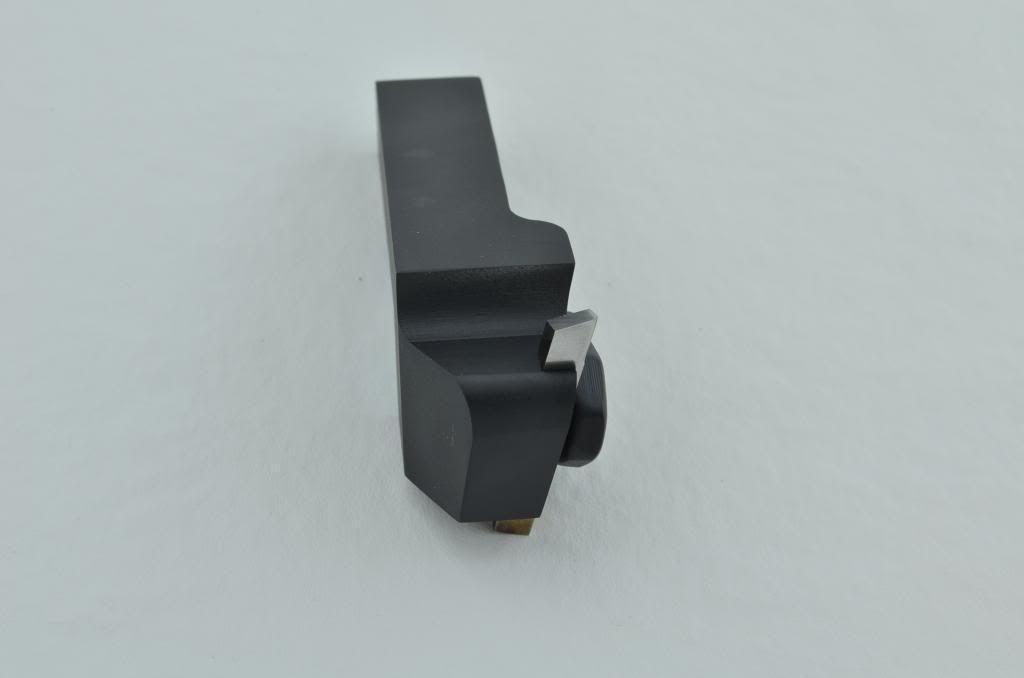

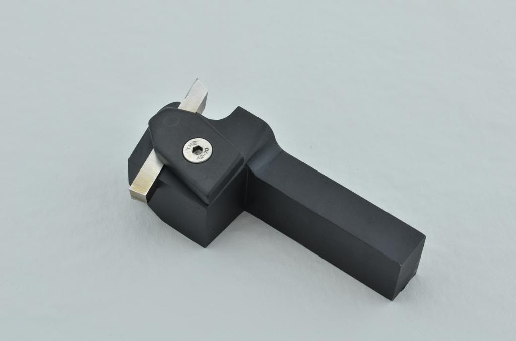

    I have used Gunkote for finishing firearms for a few years now, but I had not tried it on anything else. Awhile back I made my version of the diamond tool holder and I thought I would try coating it with the last little bit I had in a can and see how it held up. I have been pleased with the results so I thought I would share it with the crew here. I have used this tool for a few months now on a regular basis as you can see it still looks good. I am not hard on my tooling so bear that in mind and I typically clean everything up after each project. Oil and solvents don’t affect the finish and that’s what made me think it might be good in this application. For the pictures I cleaned it up with some acetone and reassembled it. You can see the spots where the screws clamped down on in the QCTP holder but that’s about it. I’ll let you be the judge. Oh….and no I am not affiliated with Gunkote in anyway.

          that's what I was so impressed with. Once I cleaned it up I couldn't believe how well it held up. I knew it was some tuff stuff from using it on guns, but tooling is a different story.

                      The tool holder is really quite easy to make. This is the third one I have made and once you get the set up down they are simple. I use my swivel vise set at 12* and then a second small machinist vise tilted at 12* clamped in the big vise. Hold the part in the small vise and mill the angled face of the tool holder flat and then without moving the holder, mill a ¼” slot to hold the HSS cutter. The rest is up to you and making it look “pretty” to you. If you don’t have one I would suggest giving it a shot. I use it for everything except hard steels and it produces great finishes. There is lots of information on the web about them if you Google “tangential tool holder” and “Diamond tool holder”
