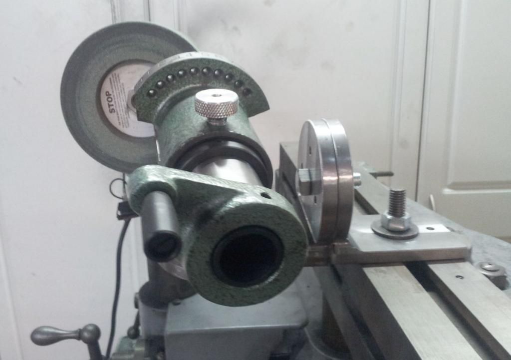

    I am building a universal head for my T&C Grinder using a cheap 5C spindex. On the original machine the spindex portion is quite short and low. The length of the tube on the new spindex prevents the holder from turning completely around. Is there any function of the spindex that would be impeded if I shorten the tube?
    Here are some pics of what I have so far. I still need to do the final polishing of the edges where the graduated markings go and make the marks.

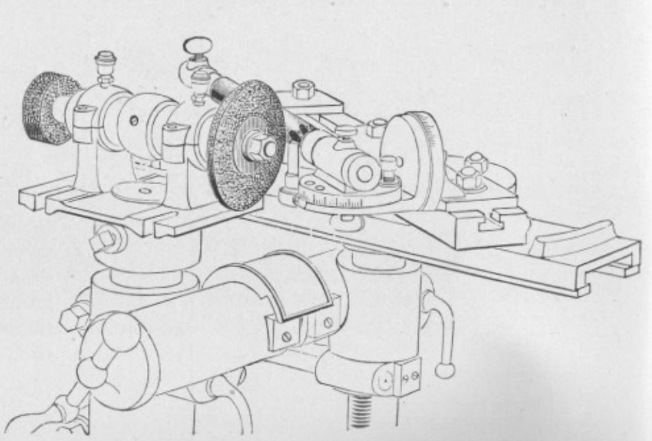

    Here is the original:
    I think the only drawback of shortening the tube would be that you would be limiting the capability of grinding longer end mills.
    How about if you flip the two piviot point discs around so they are on the under side, then you would be free to swing the fixture around.
    Also I'm assuming you mount a finger under the end mill somewhere to keep the angle correct.
    JL................
      Actually that isn't a bad idea. I would need to change where the angle graduations would go but that would also solve the height issue.
      Yes, I am trying to figure out how and where to mount the finger next.
        Personally I wouldn't, if you plan to do the flutes and slide the spindex rather tan move the table it's barely long enough as it is, in fact I've extended mine. But I also added air into the spindle bore and a tilting base to make things easier. There are some pics in the post #1789 of the shop made tool thread, but it doesn't have the spindle extension/ handle shown.
        If nothing else You could ditch the handle to stop it fouling the table, and add a large hand grip instead.
          Replace the handle with a handwheeel, far more comfortable to use.

            John is right, remove the handle. I would make a knurled extension tube and fit it to the back of the spindex spindle.
