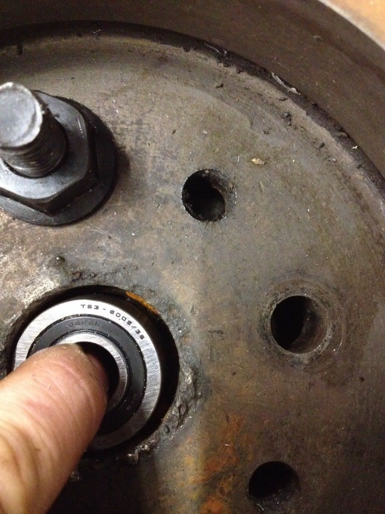

    We are preparing a site for a new house and one neighbor offered to loan us a dozer and the other would operate it. I just have to pay for repairs and fuel. Well two hours into the access road the main clutch gave out.
    This is what was found to be the cause

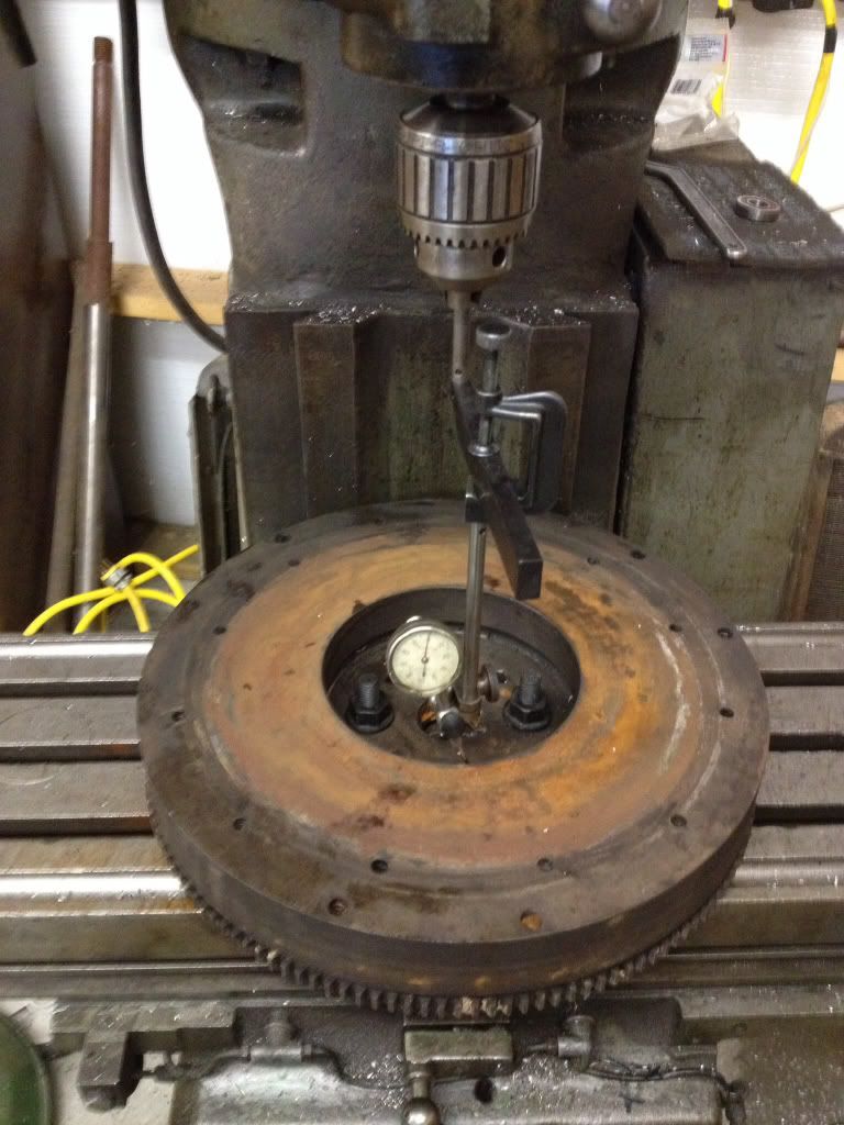

    Centering it up

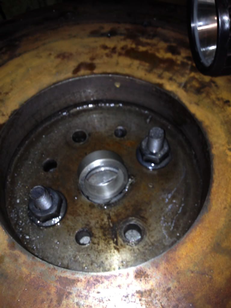

    Pilot bearing hole cleaned up and repair sleeve before install

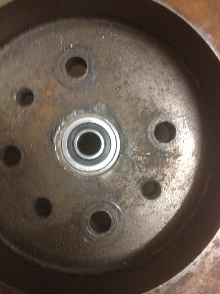

    Finished

      Good job on that repair! Hope you caught it before any other damage was done.

        Excellent. One question tho...what is that bead of weld from that is adjacent to the hole? An old repair perhaps?

            The. owner has been having trouble with input shaft bearings and seals ever since getting this dozer but never pulled the clutch till it quit working. The weld is from where someone has previously tried welding the bearing or a shim in? Made it hard on tooling to bore the hole out. I ruined two carbide endmills trying and stopped when I got it mostly round. There was enough wall thickness on the repair sleeve to allow me to true it up on the mill after installing it.
              That's what I assumed. It's a shame there are people that think that they can weld, and a welder and a cutting torch is a cure all.
                That appears to be the pilot shaft bearing. With the transmission input shaft flopping in the breeze at the front end, the input shaft bearing is likely toast as well. Also mike up the front of the input shaft where it enters the bearing you're replacing. It may be worn undersized or eccentric. It's magic moments like these that caused me to get rid of my dozer and just rent whatever I need. If you think a breakdown sux in your driveway, you would really hate a breakdown on a remote jobsite in the woods with snow on the ground. A mechanical issue can turn a useful machine into a 10 ton roadblock in 2 seconds flat. Good luck.
                  ditto what Epanzella just wrote and in fact was going to be my comment but I will add the following,
                  your front main is most likely toast, that is most likely a given due to the amount of slop the other bearings bore went through,
                  now you have a situation, you've taken all the slop out of the shaft but not with the massive front main but a small little nosecone pilot bearing that's also way far away from the mains loading area - it is in no way/shape or form designed for this, you stand a very good chance at snapping the nose cone off the mainshaft if you assemble "as is" ,
                  I can't imagine all the work you had to do to get this far just for two hours of use of their POS,,, don't get screwed even further - tell them what the score is and let them know you need "real money" for all the work your about to do on top of the barter you got going on ------- one should not have to rebuild an entire dozer drivetrain for a little bit of work... good luck - but please heed my warning - not a good situation to just throw it back together...
                  Edit; you are in deep - real deep - it's tranny rebuild time... I can guarantee you that once you go in to replace that main you will find so much more as everything has been running in the old mains hash, you can count on pretty much replacing every bearing in the trans if you want to do it right,,, im sorry but really time to have a sit down talk with the owners - in the meanwhile take a measurement of the mainshaft slop and let us know how much...
