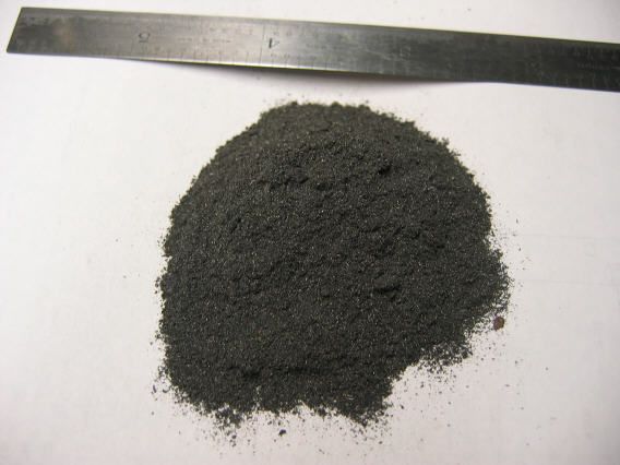

        Even a little work can make a fair pile of stuff.
        This is what came off a small mill column, I was curious so I saved almost all of what was removed.... It was in a similar shape, not flat and in that case also at an angle to the spindle (despite the flaking, which I did not believe in, someone just "oil flaked" it)
          I'll agree with the fair amount of stuff, Calculating from the volume removed, I took off over a pound of scrapings from the to of my mill table as the first part of scraping it true (10x48" table was hogged by .010"!)

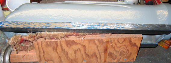

            I did find one of the ram in progress.
            One side of the slide partway into the scraping. It's better than when it started, but there is still no contact whatever at the nose end of the ram. It's hard to see in the picture, but the very rightmost end has essentially no blue on it.
            The actual nose will be scraped to put the rotating part at a good right angle to the ram ways later. I'm not worried about that yet.

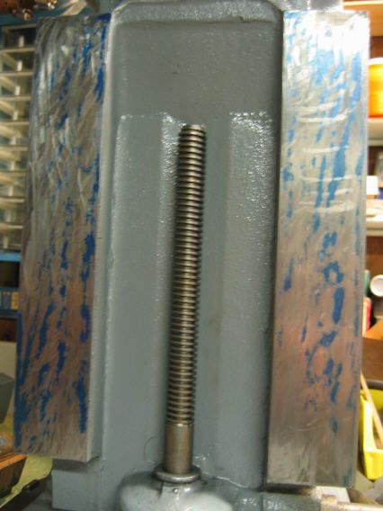

              Spotted with my 9 x 12 "chinese tombstone"... one that has been checked against others and seems decent...
              Time to start checking the alignment against the ram ways now.... so both flatness and alignment can be "brought in" together.
                Are you bluing both sides of the ways together? That looks like when it comes in it's going to come it in a bang. Just a few islands here and there. You can see the bullseye high spots on the right side just below the vertical center point.
                Come to think of it - those surfaces are clamping points more than sliding ways on the Atlas shaper - you probably don't need to get all that close unless you're going to use the table lift in contouring operations.
                  The tombstone gets both ways together.
                  It's early to worry about bullseyes, first there needs to be contact in spots over the full surface, which isn't happening yet. There are "holes" and untouched areas, for instance at the left of the left surface, and the bottoms of both. I have some more "shoveling" to do.
                  My method is to work for full area first, and sweat the details later. But it's a lot less work if you take notice early of how the alignments are. In this case, original contact of the "x" test was only in a few spots on edges, and quite a lot of material needed to be removed to bring it to this point.
                  Coming in with a bang? yeah, hopefully.... Unless you are pinpoint spotting for a reference surface, it usually DOES come in fast. You get full area distribution, then a few rounds of spot-splitting, and suddenly you are at 10 to 15 spots per inch. Another good reason to check alinements... you don't want to be trying to adjust an alignment after you have got it to 15 spots....
                  Yes, it's a clamping surface, but all that means is that the contact may be fewer spots. But if the "ways" are not kept in decent alignment, moving the table will shift the work around and surfaces being worked on may not turn out right in using the device. Plus, there is no reason NOT to keep good alignment, other than wanting to be done... Anyhow, that's how I prefer to do it.
