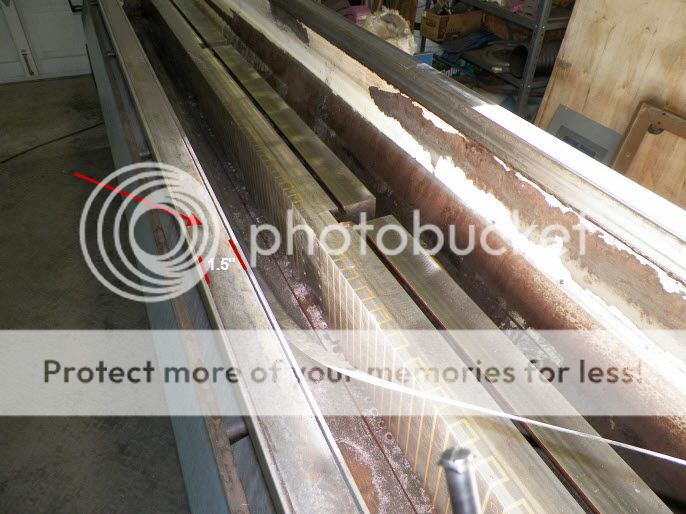

    I'm about to tackle a project that is long overdue, but not one I'm looking forward to. This way is about 12' long, but lucky me, I only have to worry about 10' of it. Over about 30 years of use, it has managed to accumulate a considerable amount of rust pits and wear resulting in an up and down pattern as the head travels over it. The difference from the fairly unused end to the highly used end is in the range of 0 to around .012". When our 2,000 lb. grinding head travels over it, the difference becomes apparent very quickly. I tried a quick fix with stainless steel shims under the wear band, which helped initially, but I'm sure most of you, as a kid, couldn't resist the temptation of placing a penny on a railroad track. Over time the shims began to look like that penny. Thus, the time has come for a more substantial fix.
    I have read about Moglice for years, but have never seen it, nor tried it. That is about to end. Now that I have the product in my hands, I'm reading on the brochure about its machinability like steel. I've spent a fair amount of time behind a file and sanding block doing auto body work, but somehow, I have this nagging feeling that this stuff is going to be a little tougher to cut down and get to the desired level. Has anybody dived into this end of the pool yet and come up with any suggestions?

    Moglice would be fine for the wear on the head side but may be difficult to use on the bed half. I thin I would have the ways reground. I think that is going to be the best solution. Or have it milled down and install modern linear bearing rails and blocks.
      I did leave out an important element. These ways are covered with a .033 Stainless Steel wear band. When it wears out, toss it and start over with a new one. The problem is the underlying support of the way that you are seeing. The wear band covers a lot of sins, but it still dips, particularly when you're talking about that kind of weight rolling over it.

          I have repaired Plywood Mill (mfg.) brade grinders that was inside a room on the 3rd floor as the blade grinder was placed in the building before the walls were put up. So sending it out to be machined was not an option. The cast iron base under the SS wear band was pitted as your's is. On this machine ball bearings rolled on-top of the bands, I filled in the rusted holes and pits with a product Moglice makes for filling in scores Score-ex. Moglice makes several types of products one is for the shorter way bearing surfaces as macona mentioned. I made a depth gage that mounted on the to outside uprights and mounted a dial indicator so I could make the pitted surface parallel to the top sides as it was machined at the factory at the same time as when they milled the pitted surface.
          After the Score Ex dried I filed and sanded using a steel block with sand paper until it was with in .001" parallel and flat. It was a messy job, but worked with help of a shop vac. I also ran out of the Score-Ex I went to a local auto store and bought a product called Liquid Lead. Both products smelled like Fiber-glass and dried as fast as Bondo... Less then 10 min. After we finished we also sprayed the new surface with a clear coat varnish to keep the coolant from eroding the metal again.

            It's good to see somebody else has been through the wars of pitted ways and wear bands. Actually the product I received is from Devitt Mach., and it's called Diamant Plastic Metal from Germany. By now I'm sure Moglice has been tossed around as a generic term for metal filler. It's still a plastic bonded metal filler.
            In any event, I'm happy to see that you used a sanding block. I was getting seriously concerned about how I was going to "sculpt" this surface with normal abrasives. As for a reference point......that drove me crazy. I finally settled on the side of the chuck along with a slapped together rig with a dial indicator. I reasoned that if I was consistent with the way vs the chuck, then things can't be all bad. Then, I discovered that the outside of the way is .035" higher than the inside of the way, presumably to give the head a "pigeon toed" track, thus keeping it pointed inside. That means my dial indicator has to follow the same lateral track all the way down to sculpt the Moglice consistently.

              I would still use the outside edges of the area where the ways are and not the chuck side. As you will be multipyling the error from one to the other as you reach out further on the back way then to then the front one, possibly doubling the error if the chuck top is out of square to the ways. You could check the top edges on both ways front and back and f they read the same your metheod will work too. i have found in many machines; lathes, mills, grinders the top clearance surfaces work to measure from and were parallel to the ways from the factory. To check the error I would measure the ends where there is no wear and running it on the top edge of each way independently from the other side. On the Blade grinder I did the rollers or wheels (sealed ball bearings) were on a eccentric cam shaft so you could adjust the height so they hit the bands at the same height and we adjusted the head stock spindle to so it was on an angle so the blades were 10 degs. (rake or lip clearance) out of square so they would shave the bark off logs. Like I said Diamant products in the brand name and not the material type. Be sure you have the right material for the job. Better safe so you can sand it and not the material you can't sand or cut with carbide. Moglice is not a miracle material. It works well in some areas and not so good in others. Remember they are "repair" materials and will probably need to be "repaired" again. One very important thing you have to do is clean the iron as it is now full of oil and water.
              I would use a propane torch to heat the casting to sweat out the pours.You can heat it up and watch the oil and water wick out. Be careful not to get it to hot as you will melt the iron or it may pop out. I would never use a acetelyne torch as it will get it to hot. Heat it up, wipe with a white rag, let it cool, wash with cleaner, heat it up and repeat until the white rag does not get dirty when you wipe the metal. The Score material will fail or fall out if the surface is not prepared and cleaned. I also used a cut off wheel and carbide burr to make the bottom of the pits deeper and wider as if you don't do that the material will work out. It won't just lay in a pit and not come out. Think of it as a "pot hole" in the road.

                The material Cody recommended is PlasticMetal #0067. I don't think it's wayliner, but after reading your last, I think a little test is in order. Would hate to start finding out after it's already on, and yes, Cody did instruct me to peck some .100" holes, 1/16" or so dia. around the pit areas. Not real sure how many, and how dense, I need, but I guess I'll just have to wing that one.
                We grind the usual varying collections of PVC granulator blades.....Cumberland, Zerma, Econogrind, etc. They vary from as small as 12" long to bed knives at 42". As expected, the rotors are ground on angles, while the beds are very little angle or even flat.
                The last time we cut/dressed out the chuck, I first dialed the spindle "flat" with the chuck, then cut. After that, I flipped it 90°, as you see in the pic, and cut that side. My partner was questioning me at the time why I was cutting the side of the chuck since we don't grind there, and I said that I wanted a square reference to the front. I didn't know why at the time, but I kind of knew it would come in handy sometime in the future. Now....the big question is whether the chuck is flat from end to end, or is there a slope, due to bearing wear, etc.? That I don't know, and I don't really know how to find out because it is our reference point. I guess, at some point, there has to be some blind faith. Sometime last year, I mounted the dial indicator to the head and tracked it down the chuck. I made a map of the dips and valleys as it went down. Now, as I move my indicator base down the chuck, as in the pic, I'm seeing the same thing, only a little more accurately, so I'm feeling a little better about it. I fully understand the need to track the same line down that way in order to get the same measurement for the Moglice sanding, as well as maintaining that slope. I'm going to have to modify the base to accommodate that task.
