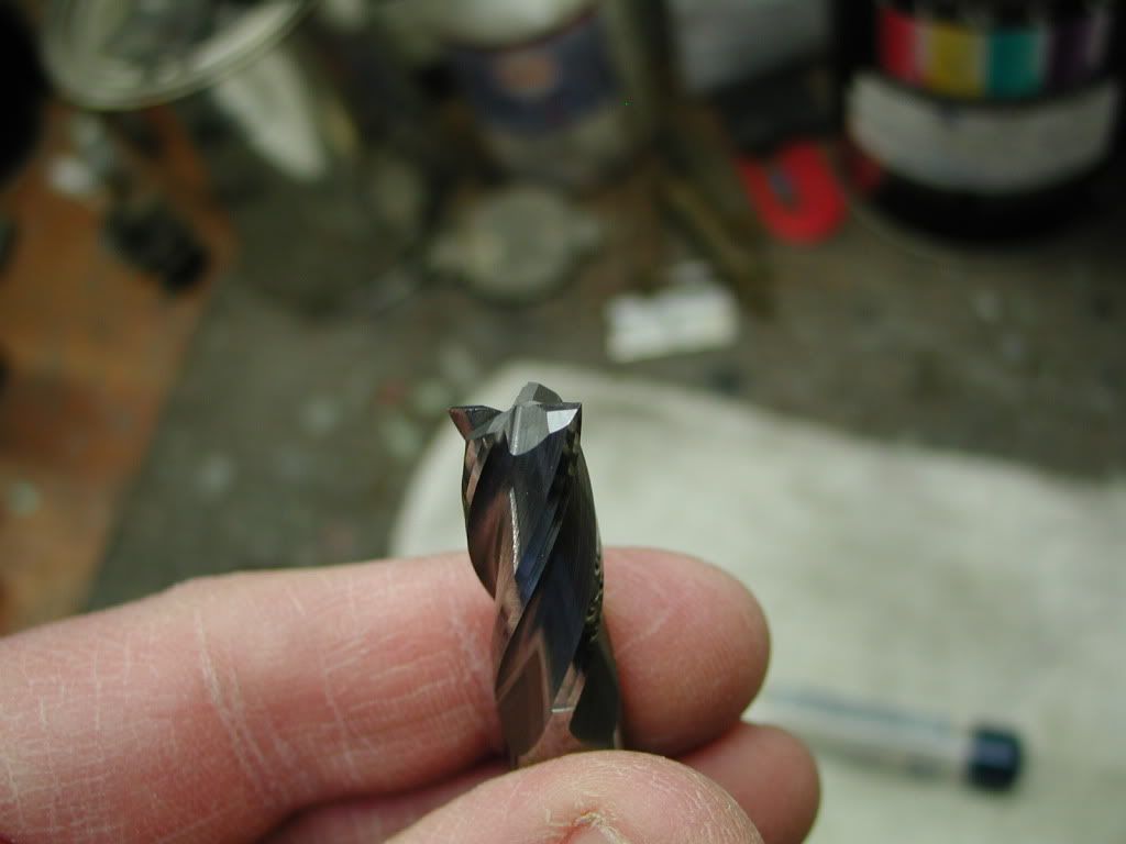

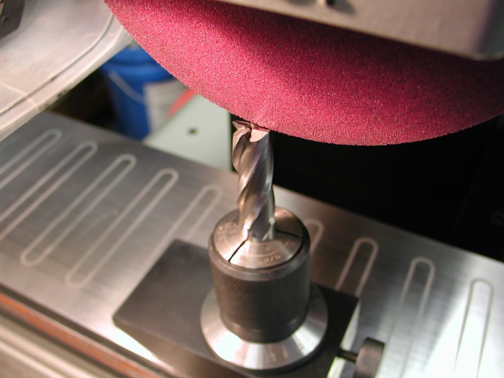

    The past few days I've been sharpening my cutters. I've noticed more closely that there are several different methods of gashing the end mill between the flutes. The cutters with a pilot hole generally aren't a problem with clearance but the center cutting ones are, especially after they have been sharpened a few times. I usually jut X the centers if needed with a Dremel, crude as it is, but some of these end mills have an under cut gash. Wondering what some of you guys do in these various situations.

    The one in the bottom picture is how I do them. The main thing I try to do is keep a straight or nearly straight line on the end where it goes from the flute part to the center. If there is much of a step where the flute is dished out, then a straight part to the center, the step will be higher than the outer edge. I think you are doing fine.
      The picture on the bottom is a factory ground, I didn't cut the gash, just touched up the cutting edge. The problem is when it does come time to recut the gash it can't be done on the surface grinder with that fixture or wheel. I'm going to have to use a cup wheel like an 11v9 or something similar to do that and will have to come up with a way to hold the end mill at the correct angle. Sounds like a job for the T&C grinder.

                  I grind mine on the surface grinder and do like Sun God says. I dressed a thin wheel to do the gash with the fixture on the secondary relief setting.

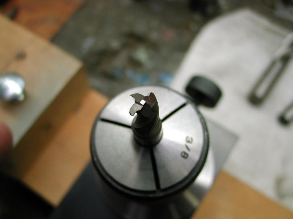

                    I cut the gash in this one this morning with my Dremel. I just followed the original gash angle, it's a little ratty on the top edge but it'll work just fine. I'm going to have to come up with a fixture to hold these on the T&C grinder and use the 11V9 wheel if I want to be more accurate. With an adjustable fixture I would then be able to cut all three angles on the same machine elim inating the second op.

                              I have just started playing around with the same kind of fixture. I tried to hold my endmill the way shown in the start of this post. I got a square section in the middle of the endmill. I tried turning the EM about 89 degrees by MK#1 eyeball and ground the EM and it came out like the first picture. the web could use thinning. The second picture shows the center relief. It measures about .025 deep on a 9/16" endmill. Does this seem excessive? Would it hold up?
