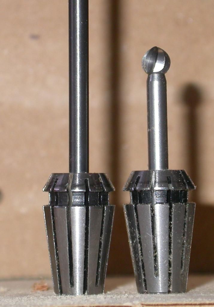

          It depends on which dimension you're talking about. I have several ER11 collets that have the same ID but the overall length is different.
            That's interesting. Where's the extra material? Is the long taper just longer, is there more length above the groove or what? And is it what might be just slight manufacturing variance or does it look like a design change for a particular reason?

                    Here's a shot of the two collets:

                        Kind of hard to tell from the picture if the one on the right is really longer or not when they are sitting on a cushion. Also, I hope that you are blowing all that crap out of those collets before you use them. Not good to use dirty collets. Compressed air will do the trick.
