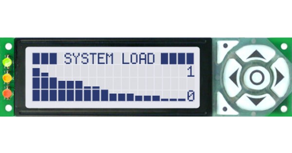

    I got the declination fine adjuster installed last night. It came out of an old Sperry Gyroscope Tool Set I got a couple years ago. A little overkill but it should work fine. I also made up the clamps for the Dec adjuster as well.
    Next is the dovetail saddle for the scope and the mechanical portion of the scope will be done. I need to start ordering some parts for the control system, a couple AM26LS31 line drivers for the step/direction inputs of the servo drives and the bluetooth module for the controller. A guy at the local Dorkbot meeting gave me one of the Orbital LK204 serial LCD/button modules. I might try to use it as a control pendant.
    20x4 1U Character LCD Display HMI with Serial RS232, TTL,USB, I2C with a 7 key backlit Tactile Keypad and 3 LED's
