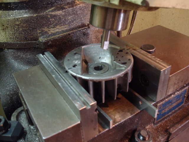

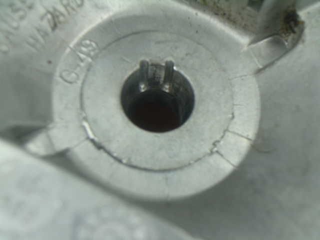

    anyways - flywheel key was sheared, and it's simply an aluminum (or was) protrusion of the flywheel material itself that fit into a .125" crank key cut out (kinda half moon) in the crank itself ---
    so the big dilemma was the fact that on each side of the original flywheel key sides for some reason ryobi has a vacant as seen in pic... probably to try to stop HSM guys from just broaching in a .125" slot in the flywheel and installing a regular key like normal people would have done in the first place...
    so I had to go oversize on the keys flywheel side - way oversize like .250,,,

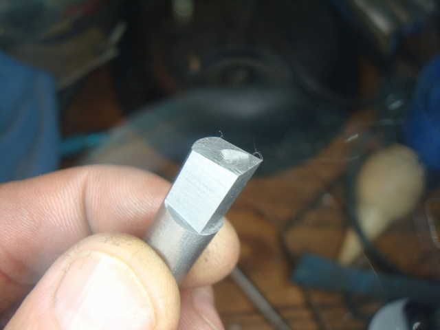

    so I built me up a ryobi broach;

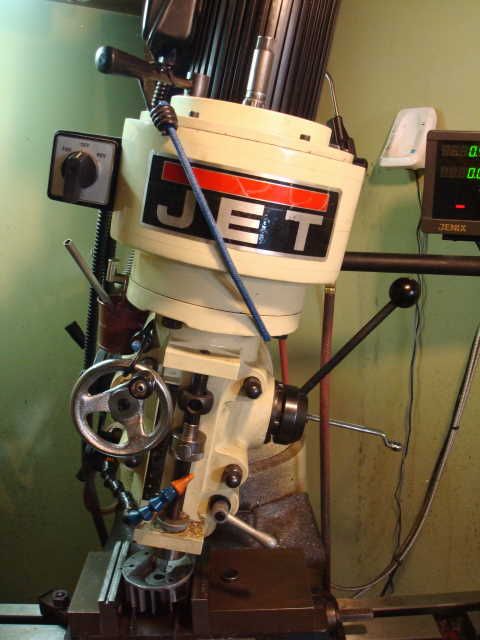

    chucked er up
    locked the brake (don't laugh the bungie works just fine although I could have used some help getting it back off)
    and the rest was shall we say history, oh - not quite - had to build the damn key...
    So start broaching - cut like butter .010" a pass and pumping the quill makes quick work...
    get it to where I want it and call it good,,, don't have to go too deep, not like the things going to be holding a chevy front end together and if it did it would just be another recall anyways...
    removal of the flywheel reveals some nice verification "curlers" from my 15 degree rake of the home brew broach tool...
    as far as the keyway --- we don't want to talk about that too much as after machining it the fun stopped and skin is a little thin around the thumb and index fingers from the grinding wheel and then the hand stone...
    but; get it all back together and third pull she fires off and would not quit,,, would have started first pull but was all loaded up on fuel from improper ignition timing...
    Lot's of procedures to go through just to save a dang weedeater,,, but weedeaters are needed, so the resources saved with not too bad an effort and really nothing that I did not already own I think it time well spent...

                          Nicely done A.K.. Doesn't your spindle brake lock by camming it up/down?
