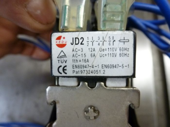

    I have a 120vac induction motor on my lathe and I need advice on wiring a switch on it. The motor has 5 leads labeled D1, D2, K1, K2 and a ground. The power cord has 3 leads L1, L2 and a ground. The switch is an on/off button type and has 6 leads with no labeling. The original switch had a different configuation going through a For/Rev switch, which I want to elimnate. My wiring experience is minimal and needless to say I need a hand in hooking this up. I do have a decent multimeter and have a a small amount of experience with it. Any help would be appreciated.

    Oh, yeah, the switch...... well connect one portion in series with each wire going to the mains, other than ground. For instance, motor goes to 1 and 3, cord goes to 2 and 4.
          There are 6 leads coming from the switch. If you look at the switch picture, on the left side -I'll call them 2, 4 and 6- they are separate. On the right side there are 2 leads on the #1 lug and 1 lead on the #3 lug. I don't know how that would work. Does it matter which side the cord runs to?

            J Tiers. I found an old switch with the right configuration, hooked it up and it works. Thanks for getting me on the right track.
