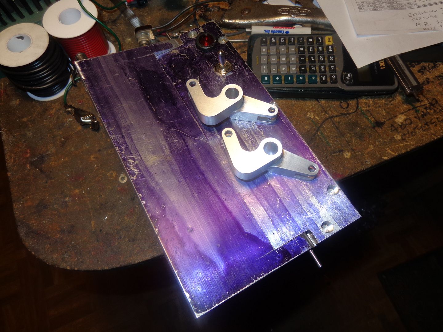

          • Any possibility of testing the SLS/DMLS waters by trying
            Selective and/or Direct Metal Laser Sintering or at least
            sending out an RFQ if a future build has a part like the
            "Connecting Arm - Opposed" that Toolguy supplied for the
            "A different opposed piston engine" of 2013?
            There was push-back generated in response to the suggestion
            at the time. I appreciate that you responded then to express an
            openness to using modern approaches.
            As one scrolls through the photos associated with these
            builds, one sees the images of the bars and plates purchased
            to be whittled into components and swarf. I believe it fair to
            say the latter outweighs the former.
            Your proficiency with CAD, the rapid development prototype
            nature of these projects, material costs of subtractive
            machining, the advances in sintered material strength and
            declines in SLS/DMLS service prices would seem to open the
            door to giving such services a try. Not to mention expanding
            creative possibilities for your projects.
            • Eddy --Machining is a hobby. If I wanted to outsource my machining I have many places I can do that. On the parts that are more complex than I want to attempt, there are other blessed souls out there with cnc capability who volunteer to help me out.---Brian
