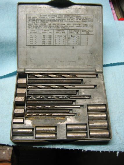

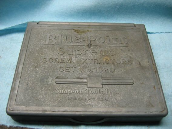

    Went a bit farther afield for tag sales, and found a few goodies that I can use, including this..... smallest size, for 1/4-20, is missing, but I should be able to get one someplace..... 20 bucks the lot, in the die-cast metal box...(snazzy, probably collectible, as if I care).
    I understand these are the best available for the purpose, so the problem may be handled.... at least for these sizes.

    I would have thought the drills should be left-handed, or is it only the flutes that are RH?
    Looks like a splined shaft that is pressed into the hole to get a grip for extraction?
    Seems like a nice set, well worth the $20.

      Still available from Snap on,$120/set and individuals forsale also.
      http://buy1.snapon.com/catalog/item....roup_ID=675450
      They do work good,they also make the second best pipe extractors.
        The drill is kind of beside the point. It just makes a hole for the splined rod to be pounded into, and then the nut-like devices on the left turn the splined shaft. So the handedness is no issue. I suppose LH they might extract the screw all by themselves. I could get LH drills for it if I wanted, the drills are standard sizes.
        The things at bottom are drill guides to make sure you go down central and not out into the threads.
          Yuup! You need to drill a left handed hole for the screw extractor to work.
            I have had that same exact set for at least 50 years and it has removed a lot of screws. If you can drill completely thru the stuck screw it rarely fails. Of course, the usual aids like penetrating oil, heat, and vibration still help. I don't know who actually makes them but I have seen the same set with the Ridgid name on them. The two smaller ones tend to get damaged so keeping spares is a good idea.

              I've got the same set, cast metal box and all, except mine says Ridgid.

                  The splined removers say Ridgid, so that would be Ridge Tools, div Emerson (or maybe Emerson sold them)
