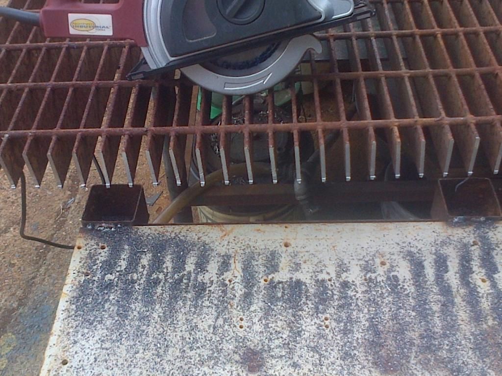

    Stopped by a local hock shop the other day because they had a nice looking Hypertherm plasma cutter sitting in the window.Couldn't come to an agreement on price for it,but did pick up this cheapo Northern Tool metal cutting circular saw.
    I have an 8" Milwaukee at work,but for the price of this one I figured I would take a chance on it and have one for home use.It was basically brand new in the case with a couple extra blades.From the looks of it the previous owner made the mistake of trying to cut Aluminum with a Steel cutting blade as the blade on the saw was completely loaded with Aluminum.Instructions say to not ever Cut Aluminum with a Steel cutting blade,but I guess he didn't read them LOL.
    Cut a few pieces of 3/8 plate with no problems,then cut some 2" bar grating.Worked very well for being a cheap saw,took my time and let the saw do all the work.Cut took about a minute and a half.Blade on this one is only 7-1/4" and didn't quite make it through the 2" thickness,but the tabs left were easy to just break off.Not bad for $60 out the door

      Except this isn't an abrasive saw,it's a toothed 0* rake carbide blade.

              Well,no,it's loud,obnoxious and leaves a fair amount of crunchy looking blue chips laying around,but it cuts grating like a dream and I love it
              I cut a fair amount of 1" grating in the course of a year and the amount of time and money I save on the much less after action grinding more than pays for the saw.I wish they had came out with these 20 years earlier

                  Definately let it do the work.One thing I did do to this one when I got it was go over all the gearbox and cover screws with Loctite thread locker.Some of the screws were loose and starting to back out.
