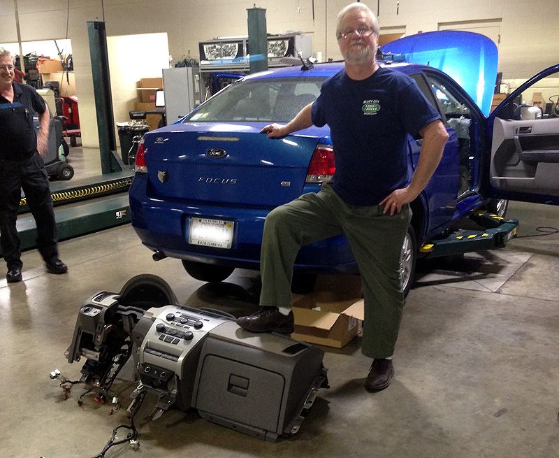

    I'd much rather be out in the shop with the A/C on making chips but youngest daughter's car A/C's been dead for several months. We've been lucky most of the summer with mild temps but things are getting nasty (heat index in the 105/110F's) here in the mid-south so it's time to bite the bullet & replace the !^#!%!* evaporator in the her 2010 Focus.

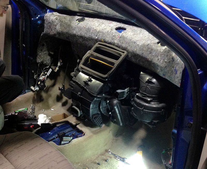

    Can you believe that??!! I'd love to strangle the bean counter that decided to save 27 cents & change the fluxing process or whatever makes these things start leaking in such a short time. It's a great little car but it's absolutely unacceptable to have this kind of failure. Ford says to replace the entire heater/air con assemble for $$$$ but Murray supplies the evap core for less than a $100.00. Trouble is, ya gotta explode everything down to the firewall to get the box out. Once it's on the bench, then you take out a zillion screws & other gimcrackery to split the box & finally get to the evap core.
    I'm too old & fumble fingered to tackle this by myself but fortunately good friend & co-worker Mike W. volunteered to help (he does all the work & I fetch things & say encouraging words & try not to get in the way.) He says it's a piece o' cake compared to the Jags & Rovers he does the same sort of work on during the day.
    (Triumphant hunter/gatherer with the dashboard beast underfoot)
    (Heater/aircon box ready to pull out & dissect into a pile of widgets.)

            Thanks for the empathy fellows. We got the new one in, the system vacuumed down & holding for 20 min, recharged w/134A & blowing painfully cold air by 2:00. Every screw, plastic plug, harness clip, bolt & nut went back in their proper place except one small heatshield retainer button that went ZING & disappeared. No interior trim parts were broken or lost. Job well done thanks to professional help.
            Whew, what a relief!! Now I gotta figure out a good payback for my bud Mike besides the $200 cash my daughter's giving him. Hmm, steak dinner, ribs & beer...I'll figger sumthin' out.

                              Yup, me too. One decision I almost made a couple months that would have been disastrous was to recharge the thing and add SuperSeal stop leak. I've used their R22 stop leak in my house a/c and it worked a treat. The manuf said on their website if the leak was large enough that the system leaked down in 2 weeks, don't use it. Hers leaked out in 2 or 3 days. I found out later that Focus's (Foci?) have some special type condenser that will not tolerate any kind of stop leak and will just plug up with no hope of flushing the stuff out; replacement is mandatory.
                              I would have never tackled this one myself without my bud Mike saying he'd do it. After over 30 years of watching him perform miracles, I had no doubt it'd get done quickly & correctly.
                              The thing was actually not too bad, most of it snapped apart like a Lego and most of the screws & bolts easily accessed with power tools. There's 2 b!tch-a$$ dash bolts, one on the left end of the dash, accessed through the door jamb & one in the center front next to the windshield. Both required a unique stack of 1/4" drive extensions & universal joints that Mike came up with without missing a beat.
                              The spring-type heater hose clamps required a tool I'd never seen before. It's a cable operated miracle tool. One end snaps onto the clamp and the other end is a pair of pliers with a locking dog. You squeeze in comfort over here and the other end compresses the clamp & locks down. Removing those hoses would've been a nightmare without it.
