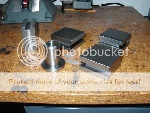

    I just thought you all might like to see the results of the recent good advice I got here. Here's my new toolpost in a partially complete stage.
    Again, thanks to all for the great advise.

                Looking good, Paul! Just make sure that the top of the compound is flat---it wasn't/isn't on my M-W/Logan and I have to shim one corner of the base to keep everything on the center line.
                  Well, it's coming along. All the top holes are drilled, bored, and counterbored where necessary. All the toolholders fit the post perfectly - well almost.
                  Now comes the interesting work. I plan to mill a flat on the post and cut one corner off each toolholder for a clamp. This should allow the tools to be removed and reinstalled in the exact same position. I started tonight but no pictures yet.

                      Actually, they don't really look that good. The faces of the toolholders are either the original mill finish or fly cut. Something happens when you reduce the size of the picture. It'a called blurring.

                          Paul, Nice work! Wish that I could get the motivation to get things done like this! Got a couple of questions..... what clearance did you use between the post and the tool holders? and are all the slots cut for the same size toolbits?
