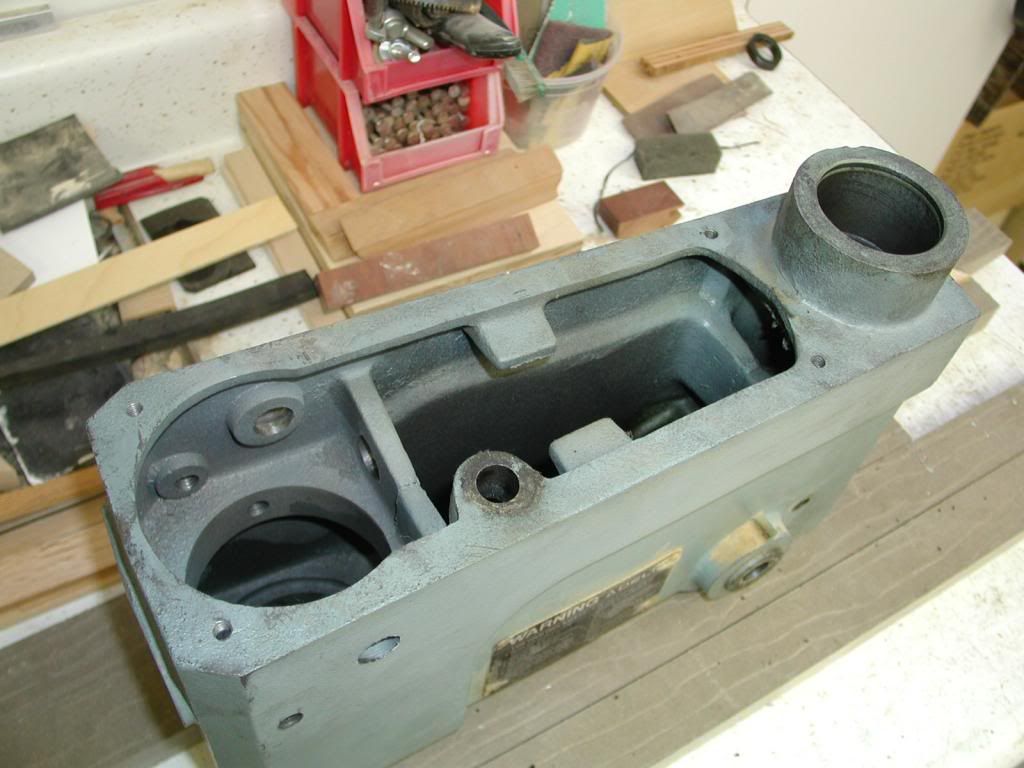

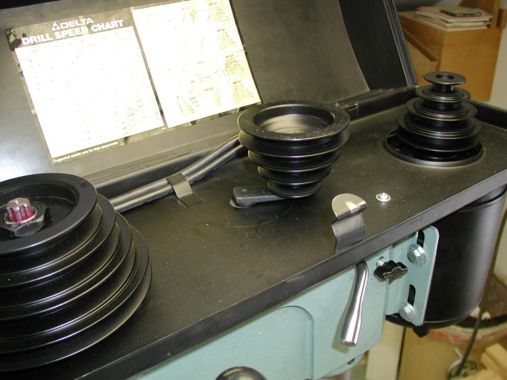

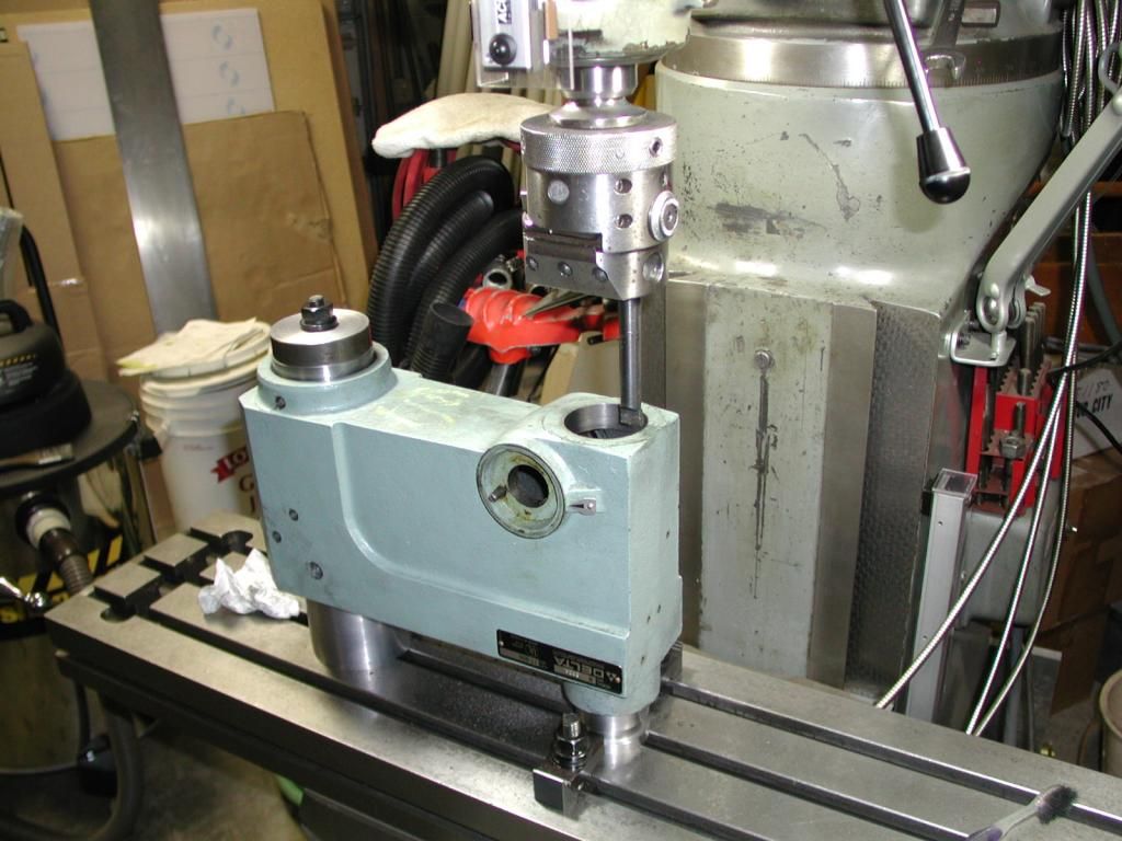

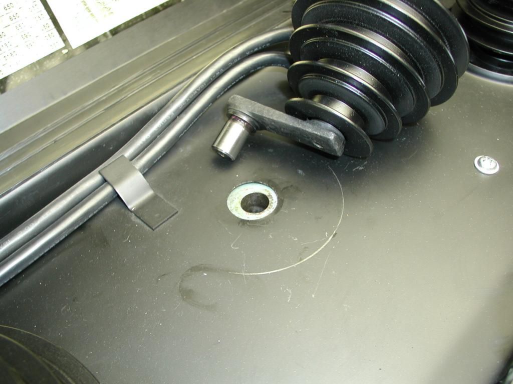

    I should have done this when I bored the head for the quill sleeve but didn't. All I would have had to do is flip the head over on the mill. Now after the final assembly I noticed that there is a bit of play in the hole for the intermediate pulley. The stud on the arm is .5585 and is good all the way around. The hole originally was .559 as that size pin goes through,and the .560 goes in about 7/16" and wobbles slightly, the .561 goes in about 1/4" so you can see what kind of shape the hole is in. The depth of the hole is 1" I'm going to have to open it up to 5/8" and make a bushing but I would like to come up with a way to do it without taking everything apart and setting it up on the mill again. I know I can't drill it by hand with any accuracy or ream it open to 5/8" so I'm wondering if any one has any suggestions??

                Turn down the stud to 0.5512" (14 mm). Hand ream the bore to 0.5625" (9/16") and press fit a thin (~0.005" wall) 14 mm ID, 9/16" OD brass bushing.

                  That won't solve much as the hole isn't round as I stated in my first post. A thin bushing like that would only conform to the oblong hole and nothing would be gained.

                    If you start with a 9/16" drill bit and work your way up by 64ths to 5/8" won't the bits just follow the original hole? Then turn your bushing to match the hole
                    and install with some retaining compound.

                              I wholeheartedly disagree. The hand reamer will make it round, on size and a true cylindrical hole of 9/16" diameter. I'm not talking about a chucking (machine) reamer here--but a hand reamer.
