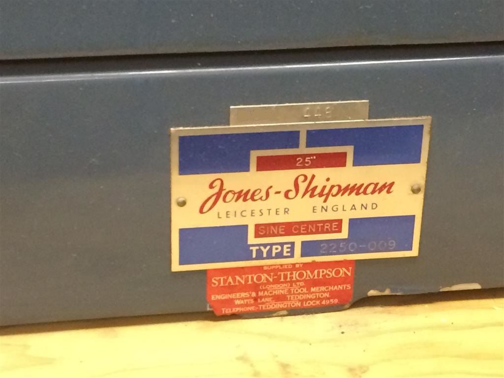

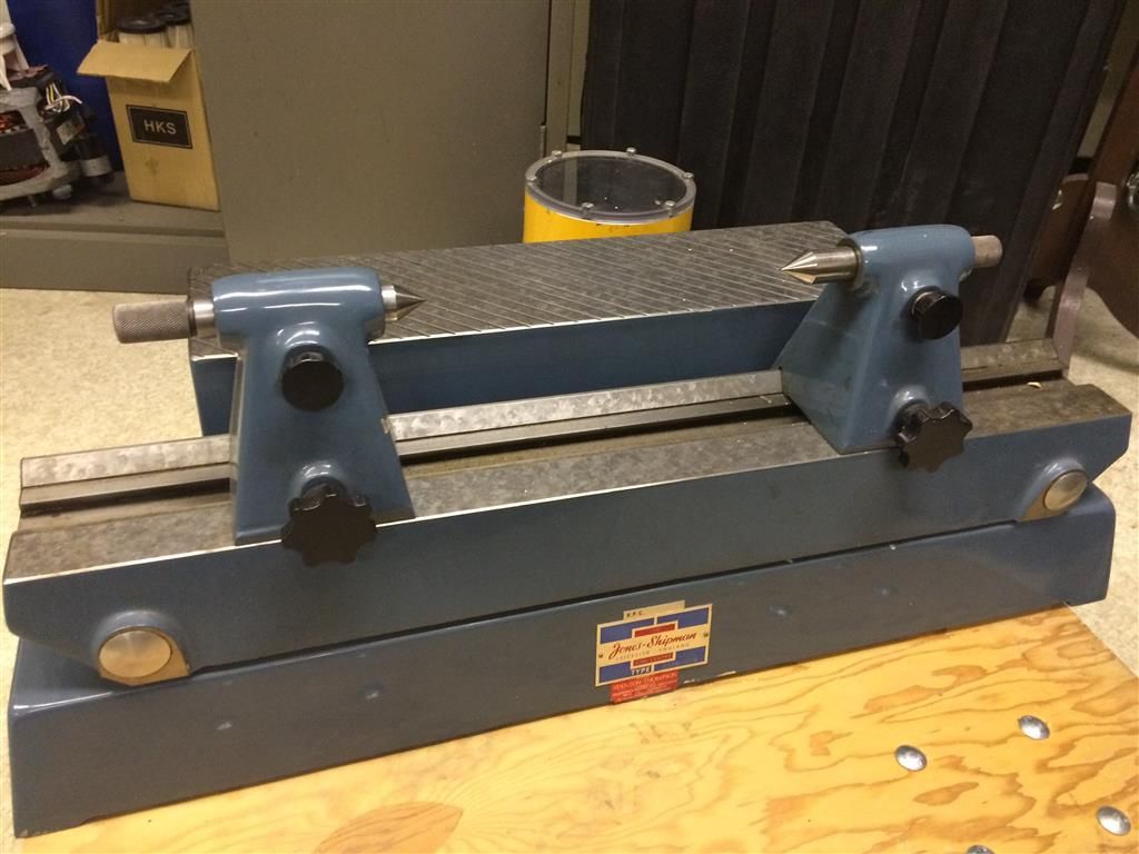

    Gents –
    I have come across this thing and am wondering if someone can pontificate on how such a thing is used. I am guessing it’s some ridiculously precise way to check tapers between centers. It came from an old metrology lab that was owned by a government organization and I am pretty sure it was never ever used. Check out the hand scraped surfaces from the factory !
    Does this have any sort of value in today’s world or is it taking up more space than it’s worth ?

    Not much info, but: http://www.judgetool.com/taft-pierce...ngfixture.aspx

        What about the "lump" in the back-ground?
        I'm more interested in that.
          The blue rectangular lump with matching paint work, not the toothed yellow cylindrical lump.
            Holy Lordy Lordy Lordy!!! I was dreaming of that thing when I wanted to check that Jarno taper bushing I just made! Are you kidding?! "Any sort of value"
            P.S. - the "lump?" To place your indicator on and slide along the edge, of course!

              A beautiful piece of kit; you appear to have summarized the use.
              What are the roll centres, metric presumably?
              Worth and value? To a HSM, a great deal if one thinks beyond original use.
              I know several jobbers who could use that; whether it is still viable these days with CMM and Faro, dunno.
                Correct!
                  So I'm thinking I should hang onto it and not toss it into the dumpster then ?
                  The lump on the back is part of the casting - it's the "level" surface you slide an indicator along I guess...
                    Oh for the hight gage!

                      It is a lovely thing, not something you see too often, my first encounter with the very same one was doing a course in a met lab, it ate my finger resulting in severe bleeding causing in the instructor freaking out about the corrosion I would cause with my obviously alien blood, they had the compound version also, someone wrote on the box, headache in a box one side and pandora a box but hope left too on the other, good catch, all you need now is a cylinder grinder to go with it, J&S made quite a tidy one

                        Care to expound on the use part?

                            Always it would be nice to have a set of precision bench centers for checking arbors for straightness, tapers and such. But not being a grind shop, it would probably sit covered more than it would get used. School shop has one, it just sits in the instructors storeroom, heaped with stuff, covered with dust.
