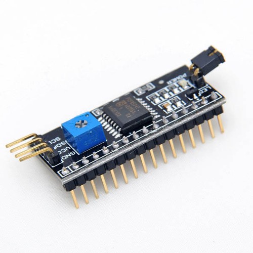

    As a project on MEM I have been working on a combination Transistor Ignition and Tachometer mostly for model ICEs, but it could also be used for any other ICE that uses a conventional ignition with points or inductive/magnetic sensor, and it could also be used just as a tachometer and dwell meter. This also shows how to use an inexpensive 14 pin PIC16F1825 (or similar device with MSSP and I2C), with a cheap $2 Chinese I2C-LCD adapter and a standard cheap 16x2 to 20x4 LCD module. Here is the schematic:
    This is the I2C module:

          The ignition side of the circuit can be a source of common mode interference from pulsed ground current if special attention isn't paid to the board layout. It's probably worth including in the diagram a chassis ground point for the BDW42G transistor rather than feeding the coil current out the same ground wire as the other circuitry. That was a problem that popped up for me back in the 1970's when I designed a similar ignition circuit. That one used a one-shot monostable driver between the Hall effect sensor and the output transistor, and ground current drove it crazy. A second monostable drove the output for the tach - a simple D`Arsonval movement ammeter, probably 1ma but I don't remember.
          A little RFI filtering at VIN also goes a long way to holding down high frequency switching noise inside and outside the chassis. Affordable PIC's have brought a lot to the game since Nixon was in the White House - wish we had Arduino back then
