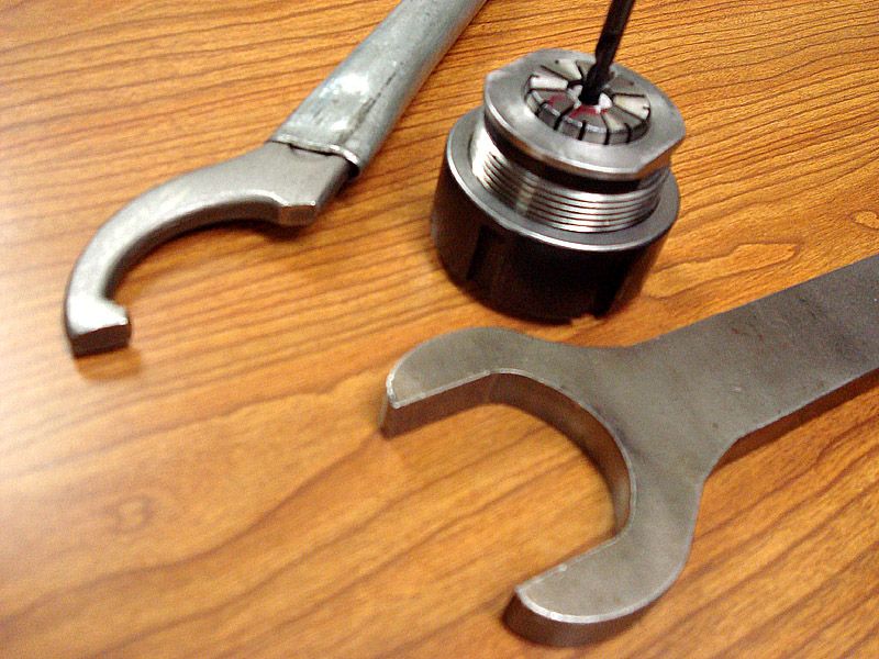

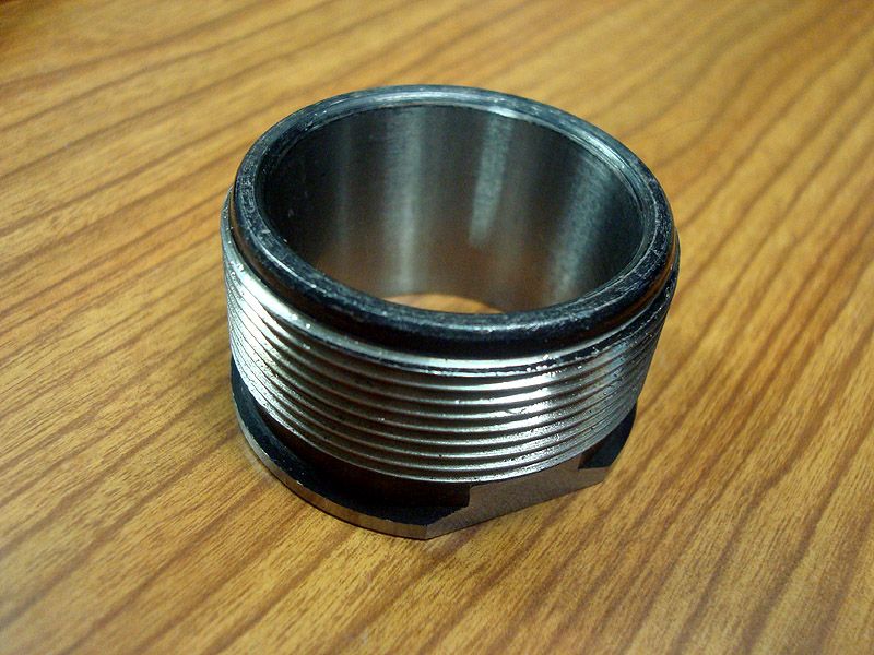

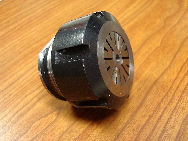

    I’m having to drill & tap some holes in my X-3 mill to mount the new glass scales and needed a drill jig. Ever since I had to get glasses with progressive lenses a couple years ago, I can’t trust my freehand drilling to be square anymore. I usually just cobble up something from scrap but the next time I need one it’s either the wrong size or buried somewhere.
    I looked around for something to make a more substantial one from and found this piece of an ER32 chuck left over from another project. I milled a couple flats on it to fit my homemade ER wrench, made up some bushings from O-1 rod and I’m in business! It feels good in the hand & is easy to hold flat against the work. The bushing can easily be slid out to control the depth as well. Now I just have to figure how to use a tap with it & I’ll be all set.

          I hear ya'. I've done that many times but as mentioned, I lose them or reuse for something else. This one along with some drill rod blanks goes in a toolbox drawer so I'll know where it'll be next time I need it. It's also easily adjustable for depth control.
          Besides, I like it...so there.
