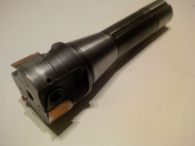

    Check it out. I found it at a local flea market. A Sandvik R-8 mill. Seemed like something I should have.
    The inserts are marked TF1000. My Rockwell 21-100 is only 1/2 hp I believe. But I hope it will be of some use.

    Menessis: What is the nominal dia. (cut dia.). It looks to be maybe 1 1/4"? May make your 1/2 hp. grunt. Don't forget to keep the speed up where it should be. Good luck.
    Sarge
      I just spent some time trying to see what I can learn about inserts. Not very productive!
      It's 1 1/2" dia.
      Menessis
        You should do OK with it. I ran far larger cutters than that on my 1HP Bridgport for years before I get the 2HP Taiwanese version, no problem.
        Since a TPG432 (or smaller TPG321?) insert will break the tips easy enough when it stalls, the cutter body itself will survive. Just be ready for it to "hammer" your spindle a bit.
        So what do you need to know about inserts?
          Well like everything else it seems, I don't know anything about them. I was looking for some sort of chart that would explain what all the letters and numbers mean. If they are suitable for aluminum?
          As long as I'm not trying to cut too much at a time I would assume I would be ok.

            Enco or other machinery supply/machine shop catalogs usually have a page or two devoted to insert decoding and selection. Go onto use-enco.com and request a free catalog. Here's a start:
            http://www.carbidedepot.com/formulas-insert-d.htm
              I think the old motors have twice the power of a new rated motor.
                Just about any grade of carbide will be fine for aluminum, though coated ones like the ones it came with may get "built up edge" from aluminum sticking to them. All I can say is run them at your maximum RPM.
                Those pages on the :technical Resources" part of CarbideDepot's website is pretty good at explaining carbide insert terminology. Feel free to ask me anything about them as well, I am well-practiced with insert terms, technology and application. I make no claims to be "the expert", but do OK.

                            Protip, Remove all but 1 insert from it and use it as a flycutter! I doubt you have the hp to use all 3 inserts on anything more then a finishing pass.
                            Once you knock the tip off a few inserts, grind the tip back so it won't ever contact the work and put them back on the head to balance the head. (Doubt you will notice the difference but it always seems better to make spinning things balanced)
