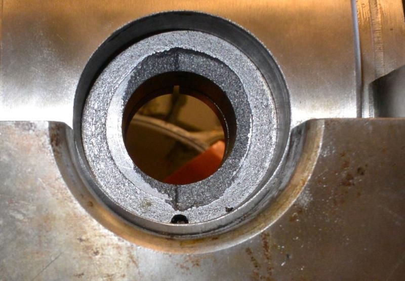

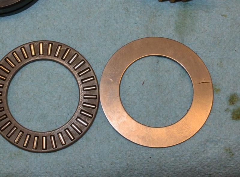

    The ratchet feeling wasn't the grit or hard grease (awful grease had dried rock hard); it was a cracked bearing disc on the rear thrust bearing. Every time the roller dropped into the crack it felt "odd".
    But wait.. How can the roller drop into crack if the plate is pressing on a solid machine surface...? uh oh.... it's not solid. Frigg... the casting was machined to the correct depth, but an occlusion still existed: (47mm plate, 51mm diameter hole):
    But... the occlusion still doesn't fully explain why the plate cracked.

    The thrust bearing and tapered bearing are pulled together (preloaded) by a threaded collar on the rear of the spindle.. To lock the preload, the collar is split on one side and a screw compresses the thread.
    Ha... the damn screw is too long. and when tightened even carefully puts a high point load directly on the bearing. This load was at 6 o'clock in the casting picture above - worst possible place. You can see the shiny spot on the screw end. It protruded about 50 thou... and I could see the contact point right on the bearing plate crack. Basically it was "locking" by driving a screw into the top bearing plate, not by compressing the threads.
    Ok, mystery solved. I might have got away just shortening the screw and leaving the casting alone, but I wouldn't be able to sleep. Mounted the casting in the BP and machined down until the occlusion was gone, about 80 thou... Easier with cnc to just use an end mill, but I could have used a rotary table or boring head.
    Much better :
