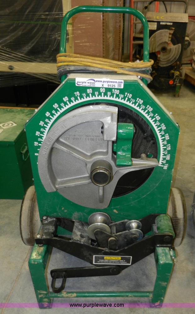

    I would like to bend some 1.375" x .080" Chromalloy tubing to 5 or 6" radius.
    I will be making my own bending dies for this and will be using a Greenlee 555 Bender with a pinch roller like the one pictured below
    Is it do-able ? - or is there some rule of thumb minimum radius I would be exceeding. Sorry its virgin territory for me and thought I would ask before I start cutting the die

            The manual for my Parker mandrel benders says if the wall divided by the tube OD is less than .07 you have unacceptable tube deformation without an internal mandrel.
            I would have to check what radius dies Parker offers in that tube size to see if your radius is within their limits.
              Thanks - I think that is the information I'm looking for. At .083 wall I should be good
                  .083/1.375 = .06
                  That's not in the acceptable range for bending without an internal mandrel.

                      Pro-Tools list of bending dies for a 1 3/8" O.D includes:
                      4 1/2" CLR minimum wall is .095
                      5" CLR minimum wall is .083
                      6" CLR minimum wall is .058
                      Using a 5" radius your .083 will be fine.
