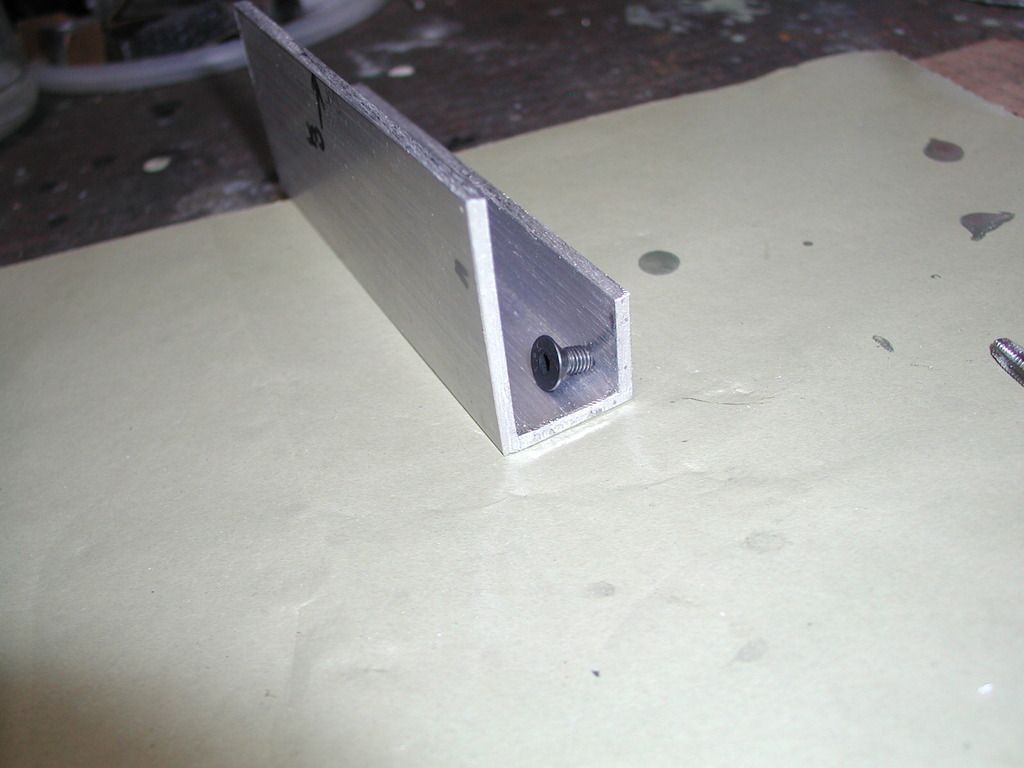

    I need to come up with a way to countersink a couple holes inside this piece of cut out rectangular tube for the FHSC screw. With out making some special cutter or modifying an existing dovetail cutter, I'm at a loss. The inside width is .750. Other ways would be to simply notch the back out to allow access of a counter sink, so give me some other ideas?????

    With something similar to a back spotfacing tool: http://www.cogsdill.com/pdf/USCatalo...utBrochure.pdf
      Can you get in there with a die grinder?

        Grind a cutting edge on screw. Stick screw through hole and mount in cordless drill. Spin and pull.
        Or make an access hole on opposite side of tube. You may want that anyway for tightening the screw.
          I like the cutting edge on a screw idea. You could use a grade 5 or grade 8 screw and it should last for a bunch of holes in aluminum.
          Another idea would be to drill the holes somewhat large and use the next larger size, flat head screw PRESSED in with a purpose made clamp. Again, use a grade 5 or grade 8 screw for your tool. You will need a good back up block with a matching hole in it to support the outside surface. This would go fast if you have a lot of them to do.
          I suggest using a screw that is a size larger so you can bring the counter sink down to the level of the inner surface or even a bit below it. That way the final size screw will not protrude above that surface.

            Make a countersink out of drill rod with a removable head that screws onto the arbor such that the cutting teeth are "up." The teeth don't have to be all that great. You can mill or file them to shape before hardening. Put the head in the slot, feed the arbor through the hole, screw it into the countersink, and pull the countersink into the hole (while it's turning, obviously).
            I've made a couple reverse-spotfacers like this. It's not particularly difficult. Just be sure to make the teeth cut in the correct direction.

                A thought that has not been mentioned is to add a
                second triangular 'filler' piece. Countersink the face
                of the triangle's hypotenuse.
                Edit: The filler piece would not necessarily need to
                be the full length of the channel. Just make a number
                of segments - say an inch long each and install as
                required.

                  This is what I thought of doing, but not too sure what the cutting edge should look like on the screw.
                  JL..............
                    It would look just like the cutting edge of a countersink. One or more cutting edges, flutes, relief, etc., except the shank would be on the nose instead of behind the head of the countersink.

                            engineers !!! ya' and I are one too. Why countersunk? Pure cosmetic or does the inside of the channel have to be clear? By the time you countersink for full depth of the head , there will ne scat material left to hold on to. Perhaps, better with an angled washer and a button head socket screw.
