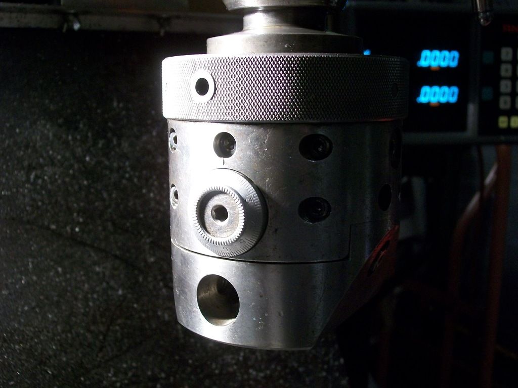

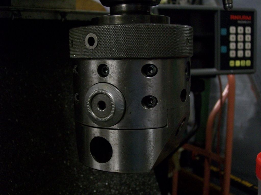

    Came across this 3-1/2" French Gamet (Enco?) Automatic Boring/Facing head on fleabay, slightly mis-advertised so had it for a reasonable price, it has 3 feed rates 0.0005", 0.001" & 0.0015" and takes 3/4" boring tooling.
    No boring bars tho so I will have to make/buy some, still no complaints from me for what I paid for it.

    I have never used one of those, but always heard they were good quality.

      Used to have one. These are excellent heads. Even if you paid full price they are worth it.

        So. Are you going to tell us what you actually paid so we can say, "you suck"?
        It looks like a seriously nice acquisition.
          Agree. Had that same one a few years back and sold it because I have a full kit of other simple boring heads and thought I would not use it much, having a full shop of both manual and CNC machines. I found out what me wife already knows. I'm an arse. Turns out that I find myself wishing I still had it about once month. When one prototypes every day there seems to be no shortage of usefulness to them.

              I have 3 boring and facing heads. The Enco Model 1002 (smaller version of yours), a Wohlhaupter UPA2 and a Niese-Koroda UFB-3.
              While my Enco is not made to the quality of the Wohlhauper or Koroda, I prefer it for those quick one off jobs. I like the audible click when the feed is engaged. It allows you to easily set the depth of cut when roughing a bore. No need to keep starting and stopping the machine, until you get close.
              My Enco appeared almost new when I got it. The first time I used it, I found out why. The taper on the R8 was ground under size and was not seating in the spindle. The shank was hitting the nose of the spindle before the taper could seat. I cut the shoulder back so the taper could seat.
