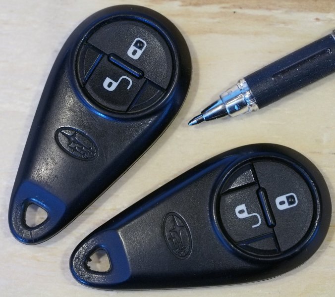

    In-laws (fixed-income seniors) reported that both key fobs
    for one car were no longer functioning.
    A quote from the dealer of C$250 apiece, plus labour
    rocked them. My search online for third-party sources
    indicated that pickings were slim and vendors were sketchy.

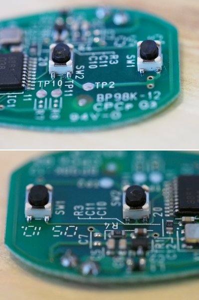

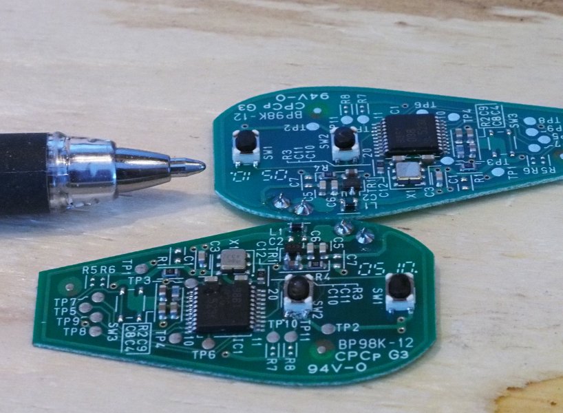

    Opening the cases revealed that the Unlock microswitch
    (SW2) had become desoldered and the Lock switch (SW1)
    joints were showing signs of fracture on both fobs.
    While I have soldered up a few perforated boards, I had
    never put an iron to a surface mount board. The concern
    was that careless heat could desolder adjacent items or
    damage the far smaller components used for SMD boards.
    With nothing to lose, however ...

                The SW2 (Unlock) switches for both fobs were completely separate
                from their boards and loose under the rubber water shield. I used
                rosin and desolder braid to lift OEM solder, then tinned the pads
                on the boards and switches. The switch was held in place while
                one pad on one side was 'tacked' to hold the unit in place, an
                adjustment was made for final position, the opposite side traces
                soldered, then the second trace on the initial side was completed.
                The SW1 (Lock) switches were still in place, but showed fractured
                solder traces. Rosin and desolder braid was applied, followed by
                a dot of solder on the tip for each of the four trace/pads.
                Very little rosin was applied. Still, Rosin Remover was sprayed on
                Q-Tips and these were used to wipe around the switches.

                  All the switches on these fobs were functioning. IMO, the sluggish
                  & inconsistent TX/RX performance, together with the leverage of the
                  exterior push buttons lead to abuse of the small solder joints holding
                  switch to board. Didn't lock/unlock with the first push? Hit the button
                  harder next time and again for good measure!
                  Incidently, the heat resistance of the white case of the switches
                  surprised me. I actually held the tip of the iron to the case to see
                  whether it would deform/melt. It probably will, but at more heat
                  applied longer than is necessary for adequate soldering.
