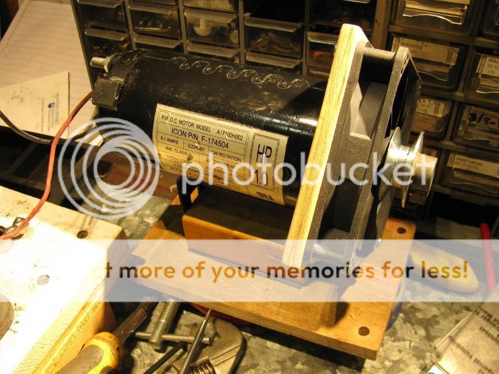

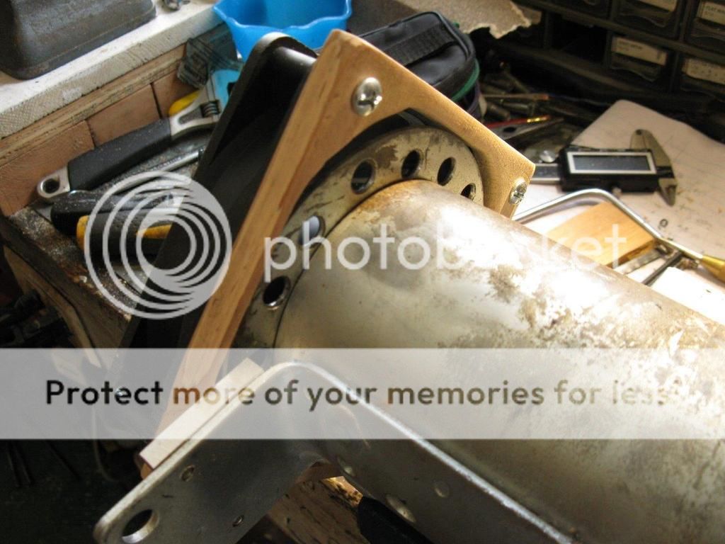

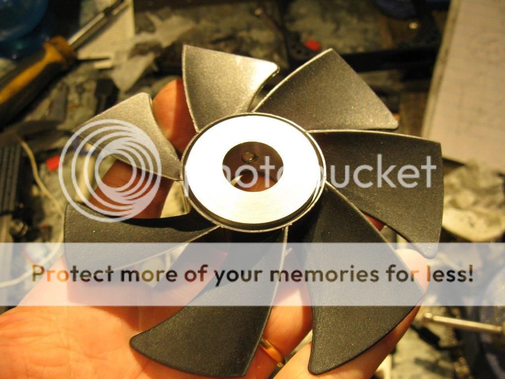

    Anyway, first up was adding a fan to the motor to replace the flywheel
    Added a shroud and drilled the flange around the motor to reduce back pressure
    Lick of paint and a pulley bored to fit the motor spindle

            You might want to consider adding a tube around the motor to keep the airflow directed along its length. I think this may become particularly
            important when running at lower RPMs and also when the fan is sucking air as opposed to blowing it along the motors length.

                Looks like there may be room to turn the motor aroung & tuck it behind the lathe?
                  ...& then install a 12vdc server fan on the back so the motor runs cool at low speed/high load. Fax me $20 & I'll show you how to make a nifty custom fit heat-shrunk plastic duct for it.
                    good idea, although I'll see how hot it gets in use first. The fan blows a good amount of air at low speeds as it's optimised for low speed low noise (Yate Loon DSL120) and blows a complete storm at 4000rpm Most likely I'll still use the pulleys and back gear to use the motor within a 25-75% band, which should keep it happy.
                    there is and that was the original plan but I didn't take into account which way the fan had to rotate to push air. I didn't want it to suck air (which is pretty inefficient with any kind of obstruction) so I couldn't turn the fan around on the shaft and with the fan rotating CW (ie. backwards) it didn't really do much at all. So I ended up just mounting the motor the other way. I still needed that space to open the gear cover, so it doesn't really make that much difference space wise.
                    neat, remember seeing that. The fan was originally rated at 25 or 30SFM (? that the right unit?) at 1200rpm and is extraordinarily quiet at that speed, so that equates to about 25-30% of the rated motor speed. Should be okay in general use, but we'll see. It's enough to blow the cobwebs off the light above it at 4000rpm!
