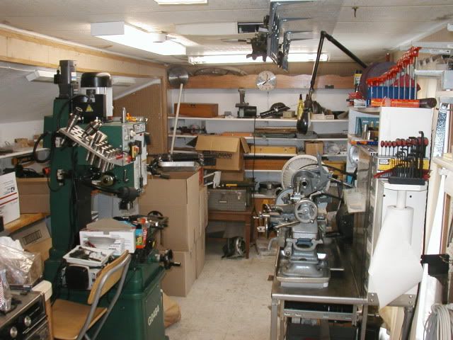

                  In my past tense, trailer shop I had them on a ceiling rack above the front of the lathe. That could be done in a regular building with a bit more of an extension. In fact, you could even have a kind of rotating rack with several bars to hold them. Spin and grab. And it would all be in normally wasted space above the machine.
                  Not a great photo of it, but it is in the top here, seen from the end:
                  When you are in a trailer you think about space in 3D and use every available cubic inch or cm.

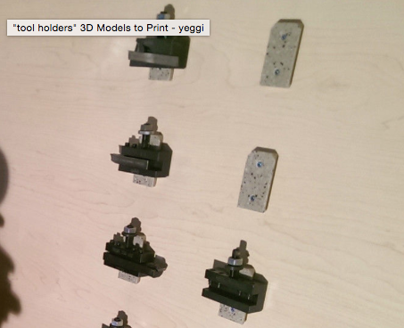

                          back OT, making the dovetail support out of a material softer than steel is an excellent idea (back to the precision surface thing... don't want to risk scratching it). Aluminum or plastic is my choice. I have seen some folks use a 3D printer to make up some dovetail holders that slot onto the chip guard or screw into the wall.

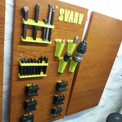

                          I have a small Grizzly lathe that has a sheetmetal back splash guard and I wanted to create some tool holders that keep my lathe tools on the sheetmetal. I retrofitted the factory cross slide tool holder with a Shars BXA series quick change holder that works very well. I made these so I can slide them over the sheet metal and hang the preset tools on the back for quick access. Some of the holders like the boring bars were just too heavy to use magnets, so this was the best way to do it. I printed these with 20% infill and made them to support a good amount of weight. I filleted the top to make it easier to swap tools on the holder. The groove in the back just slides over the sheetmetal and provides good solid support for taking them on and off.
                          I have added all holders as separate designs here below, but in short there are three types of holders on this organizer, two that gives you nine slots for 12mm lathe tooling, four that holds a tool with MT2 taper and six mounts for our quick change tool post holders.The organizer consists of:MT2 Tool holder - https://www.youmagine.com/designs/mt2-tool-holder-for-lathe-mill12mm Lathe tool holder - https://www.youmagine.com/designs/12mm-lathe-tool-holderQCTP Tool holder - https://www.youmagine.com/designs/lathe-qctp-holder

                            I have a wooden backsplash on the small lathe at work.I just cut some pieces of 2x2x1/4 aluminum angle off at a length that the dovetail in the holder will easily drop over the vertical leg and popped a 1/4" lag screw through the horizontal leg into the top angled shelf on the backsplash.
