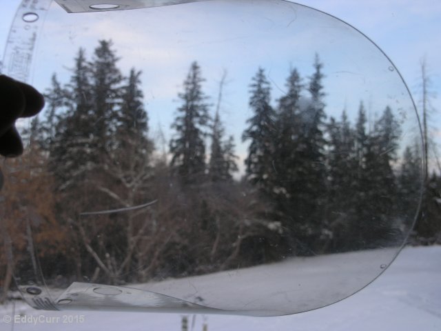

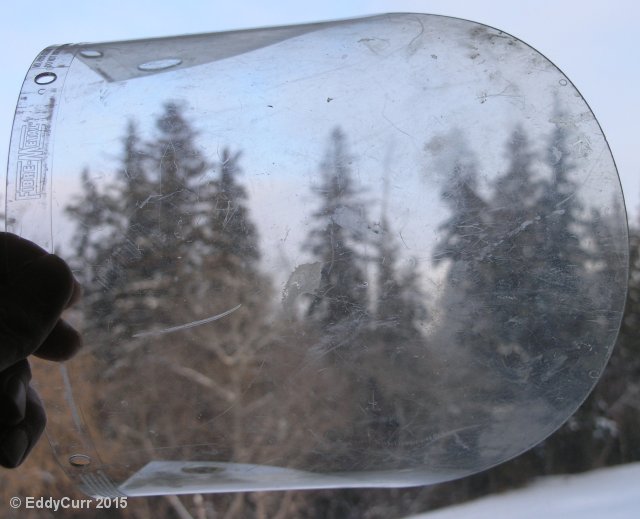

    If you are not already familiar with the benefits offered
    by plastic polish, consider familiar objects around the shop
    that might be improved with a little polish and elbow grease.
    Face shield - Before
    Face shield - After
    The face shield example above represents about ten minutes
    of easy effort using clean terry towels and a bit of a Meguiar's
    product known as "PlastX™ Clear Plastic Cleaner & Polish"
    (P/N: G12310 | SKU: 070382101237)
    Even though these images are just hand-held snapshots
    of a difficult subject in poor light, the improvement in clarity
    can be seen. The blob in the central field of vision is gone,
    the handling abrasions along the lower edge are much less
    apparent. While the deep gouges and divots are still present,
    these could be lessened, perhaps even removed with more
    work (and sand paper).
    Although I began polishing plastics with products in Meguiar's
    Mirror Glaze professional line (M17 Clear Plastic Cleaner,
    M10 Clear Plastic Polish and M18 Clear Plastic Detailer),
    I find PlastX is widely available at retailers and just fine
    for something like a face shield.
