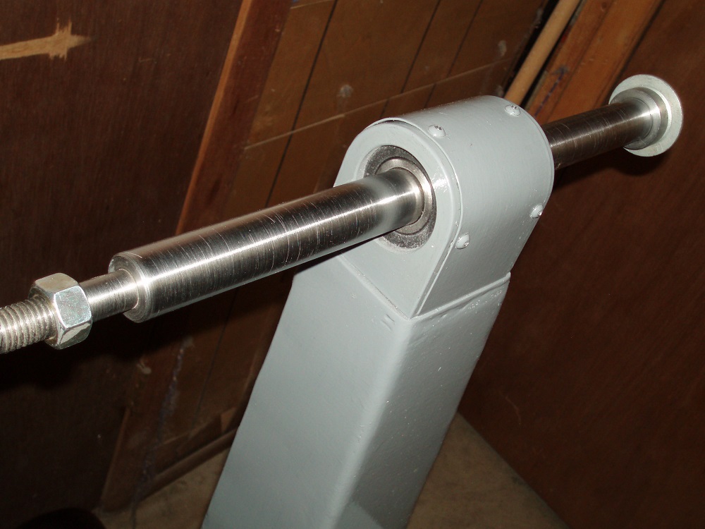

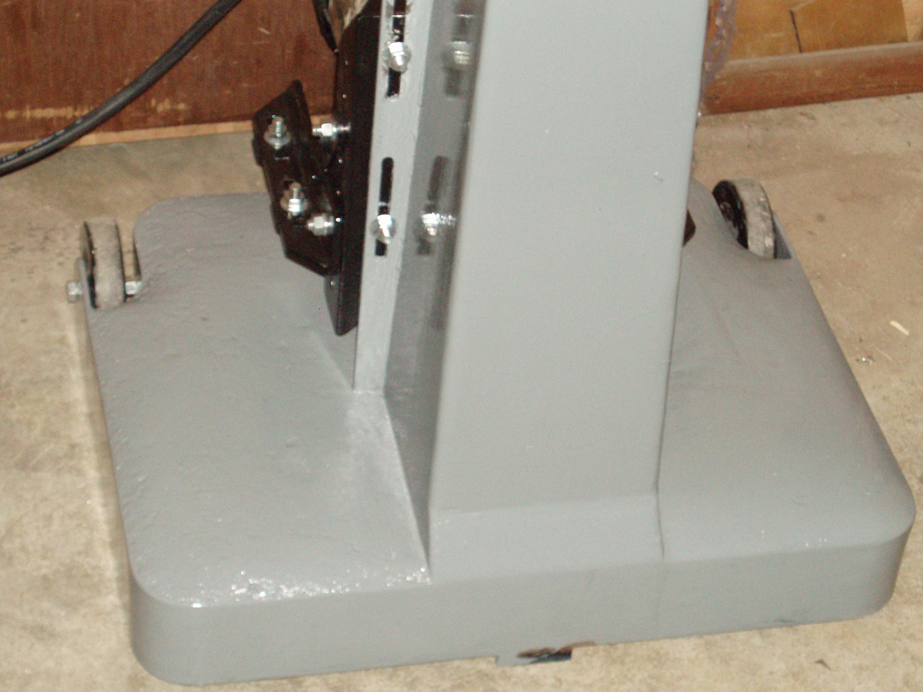

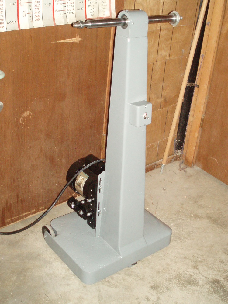

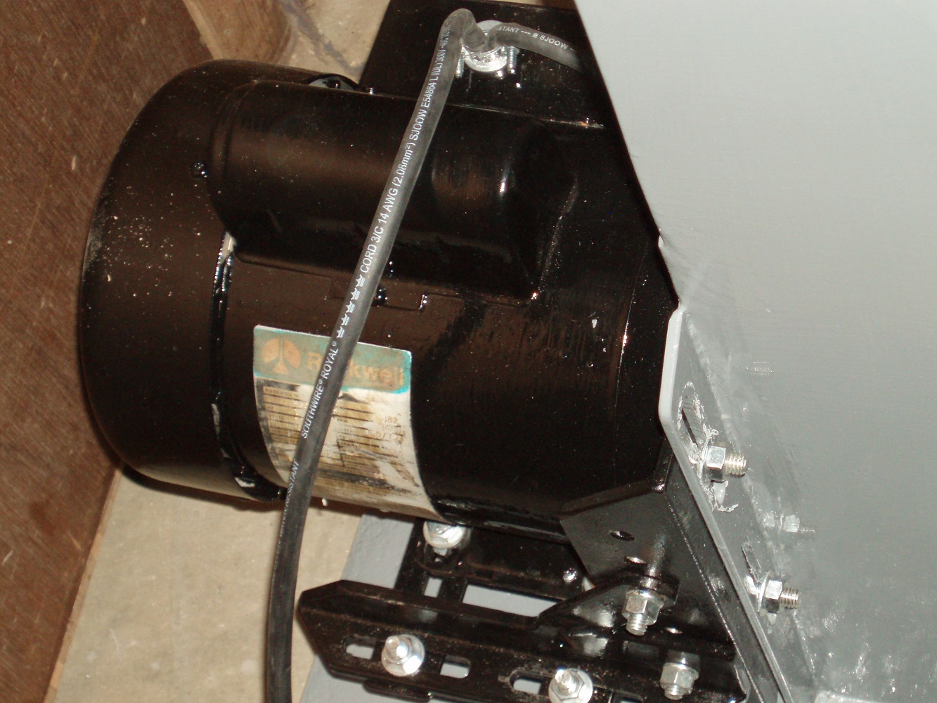

    I just finished building a pedestal buffer for my shop. It is powered with a 3400rpm 1.5 HP single phased motor. I am using an 8 ribbed J profile Micro V belt to transmit power to the spindle. I have a quarter turn twist in the belt so I can place the motor 90 degrees to the spindle and behind the pedestal. I could use some suggestion on the type of Scotch Brite wheel I should purchase for general shop use. They all seem to be proud of their wheels so I would like to get the right one the first time. You can see some of my other home made tools at: www.thekilmerplace.com
    Nice looking job, easy to get around. nice work

        Why am I thinking the base is cast concrete, or cast something?, a beautiful job, really nice.

          Fantastic.I made a buffer and it scares the hell out of me. Could you explain the 1/4 twist? Also is there a benefit to the bulk of normal buffers in the head. Does this one have enough mass in the bearing area to dampen vibration or is that not a problem. Do you have a photo from the back?Are they left and right hand threaded or is it not needed. Mine are both right handed but I locktited the one cause I dont trust it.

            I see you did'nt fancy having a std tapered pigtail thread for screwing normal mops on with. All the industrial polishers and buffers we used in the UK had left and right hand pigtail threads on each end.
