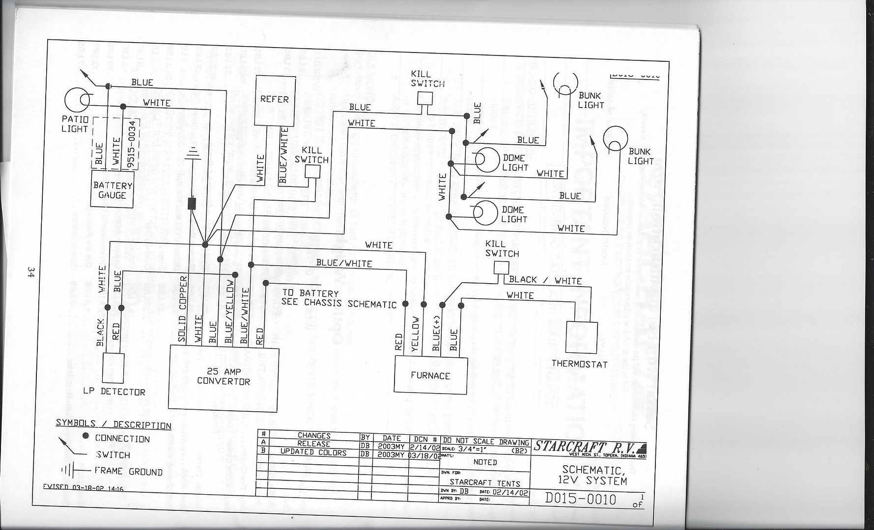

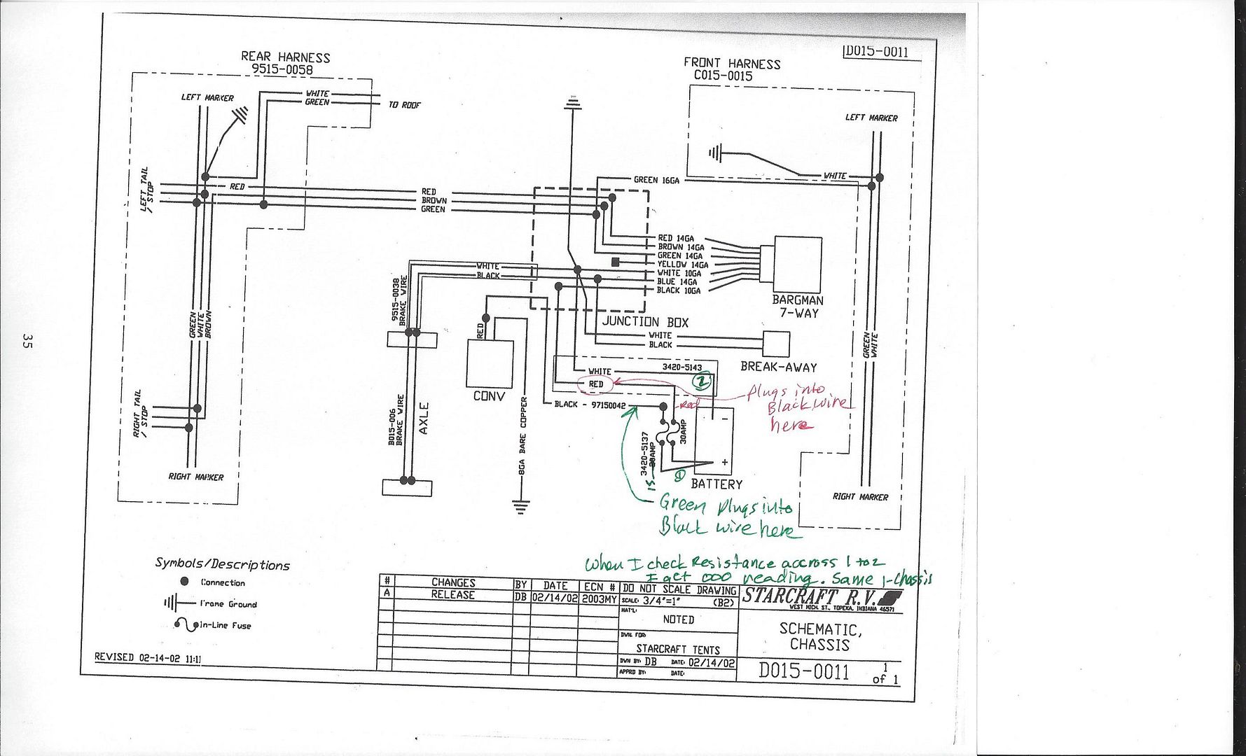

    Did some more digging in the unit and found this schematic. Would seem that it connects to positive from this diagram. FWIW, it looks like the green and red plugs to black appear to be molded and probably not an after market mod. Again, the trailer does not have brakes. it is about 1600 lb empty.
    Resistance measurement across green wire to white ground wire.
    resistance across green wire to chassis bolt was about 670 with meter set to 2000 ohms

        There shouldn't be any resistance across 1 & 2 unless the 7-way is connected to the tow vehicle. Then you'll be reading the resistance of the tow vehicle's battery which will probably smoke your meter. The resistance on the green wire is nothing more than the output circuit of the converter. Stop poking around with your meter on resistance and switch it to DC Voltage.
        Plug-in the shore power cord with the 7-way disconnected from the tow vehicle and check the output voltage of the converter (black wire). Then follow the wire path to the camper battery connector and check the voltage there (green wire). That circuit appears to be charging the camper battery from shore power.
        The diagrams have all the info you need. Start checking voltages not resistance.

            This is pop up camper no brakes. I can not see the diagram that well but the camper more than likely has a 4 wire flat connector, no charging of the battery from the tow vehicle. The battery will charge from the Convertor when plugged into 120 volt. If the wire is really green and OEM it may not be a ground. The diagram clearly shows a black wire and nothing green.

            • #21
              The diagram shows the 7 way plug.
              One wire from the 7 way plug (one that plugs into the truck) will have 12v+ when the key is turned on in the vehicle. This wire is for charging trailer batteries and will be ran from the 7 way plug to the battery with the fuse on it (the green or the red wire). The other 12v+ wire (green or red) would then go to the converter in the camper to run said equipment in the trailer. When plugged into 110v the converter like said converts the 110v to 12v to run the equipment and also sends power to the battery for charging. I always get a spark (or resistance) threw my "power in" wire as well because I believe it "powers up" the converter.

                    According to the wiring diagram, it does- or did- have electric brakes. Maybe someone hacked up the original wiring.

                        I think there's an error in that diagram where the breakaway is. Braking can be had through the 7 way connector to the vehicle, but not from the on-board battery. If the breakaway goes open circuit when activated, then it is normally shorted, which would remove voltage from the brake wire by shorting that output from the trailer brake control in the vehicle. If the breakaway goes shorted when activated, then it is normally open and will short the current to the brakes just when it's needed, but still not getting activated by the on-board battery. Black from the breakaway should go to black on the 7 way, not the blue as shown. Unless I'm completely out to lunch-
                        • #27
                          The old breakaways were wired as shown. (Can't speak on newer styles.) They had a self contained battery in a box. When the pin was pulled, it shot 12v+ from that battery straight to the brakes. The 7-way was completely out of the picture since on a "breakaway" there won't be a 7-way connection.
                          It was up to the owner to keep that battery charged. It was nothing more than an add-on accessory.
                          Oh, and you could use a breakaway kit on any trailer with electric brakes. Not all trailers have a battery like a camper, etc.
