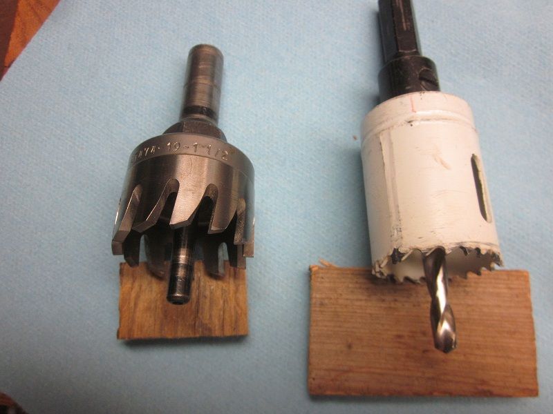

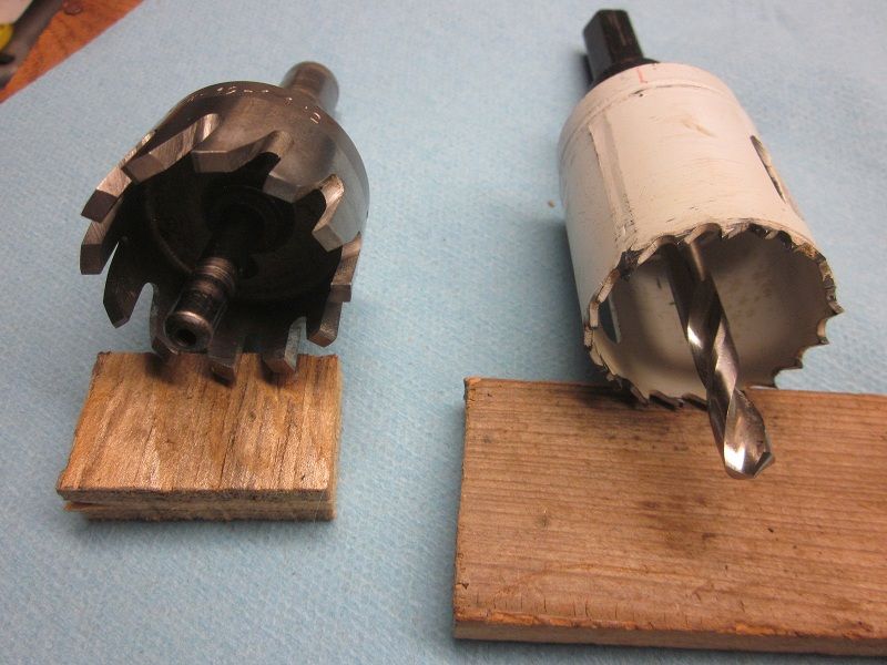

                Humm, I have to agree with Forrest. I have purchased both the Grizzly and the HF models of the 20 inch DP. The Grizzly about 7 or 8 years ago for my former employer and the HF for myself about two years ago. They look, operate, and perform much the same.
                I have not tried using large hole saws in either, but I would not hesitate to do so.
                My complaints would be a high noise level and a hard to use depth stop on both. The Grizzly did have a threaded rod for depth control, but I hate the use of regular nuts on those and I purchased a quick adjust nut for it. The HF has one of those dials on the spindle spider and I hate that even more. It is impossible to make a really precise adjustment. I plan to make my own depth stop as soon as I get the rest of my shop up and running. Both of them are quite noisy and I also plan to do some balancing on my HF.
                I was confident that the HF would handle this operation so I ran out to the shop. I could not find any 3/16" steel, but had some 1/8" so you can multiply the times by 1.5. These are some brackets that were the wrong size and I obtained about 20 of them free when the OEM replaced them. I don't know the alloy, but they are a bit harder than hardware store steel. They were to support some rather heavy, rack mounted equipment. I found a 1.5" Milwaukee hole saw on it's arbor. This is a good brand, but I don't know if it ranks with the best. The hole saw is quite sharp but the center, pilot drill could use some dressing. Anyway, here is the overall shot:
                Up close and ready to drill. I used some plain oil for cutting fluid, nothing special. The speed was set at the lowest setting: 180 RPM.
                It took about 30 seconds for the pilot drill to penetrate the 1/8" steel. As I said, it needs some attention at the grinder. The hole saw only took about one minute to go through the 1/8" steel. I did not have to use any excessive pressure and the DP did not seem to slow up by any appreciable amount.
                It's a hole! So, for 3/16" I think the times would have been 45 seconds for the pilot drill and around 90 seconds for the actual hole saw. I think I have taken longer to saw wood with similar drills.
                I believe the Grizzly I used would take a similar amount of time.
