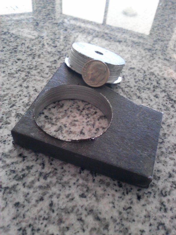

    Can i give you a tip for using a holesaw on thick plate? Drill a couple of holes on the outside (or inside, if you want a hole and not the slug) that will intersect the kerf of the saw. It will give the chips somewhere to go and will make the whole thing much easier.
    Thanks for the tip. .....though doing it the way I did was acceptable to me in terms of time it took.
    Leave a comment:

    Just installed the new 1 1/4-12 LH nut and pulley insert/pulley back into the DP. Needed a 1/2" thick by 1.5" OD slug for another project so threw in my 1.75" holesaw and some mild steel hot rolled 1/2" plate.
    Took about 3-4 minutes to drill through. Probably took only about 1 minute to get through the first 3/8"....the last 1/8" made me slow down to blow out chips as it cut. The spindle did stop 3 times from binding with all the chips....but that was my fault, not the machine's and is pretty normal with that depth of cut and a hole saw....at least it was with my HF DP.
    Anyway....so it appears the problem is simply a cheap nylon nut and either incredibly poor foresight in the engineering department or cost cutting measures that shouldn't be implemented if one is going to call a piece of equipment out as being specifically for "metal working".
