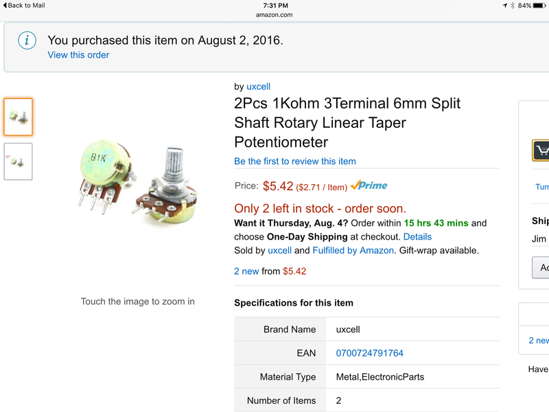

        I ordered a couple off amazon. They are 1k ohm. These will work ok then.I am a prime member and could get them in 2 days for cheap so went ahead and ordered them.
        Here's what I ordered...

                  Those don't look like very high quality to me. You may be better off with the Radio Shack for longer term service.
                  As for the value, 1K or 5K, you are probably better off with the 5K. The 1K was specified as the minimum acceptable value. Lower values will draw more current and possibly load down the Voltage source. The 5K will draw less current.
                  If you want a better quality pot, you can go to an electronic supplier like Digi-Key or Mouser.

                    Yeah, those pots are kind of crap. I always try to use the AB series J pots, they hold up to poor conditions, they are what you would find in tig welder pedals and on most industrial controls.
                      As for the value, 1K or 5K, you are probably better off with the 5K. The 1K was specified as the minimum acceptable value. .
                      +1 on the 5K, that is general industry standard value.

                        Question is whether the pot shown really IS 1K. That's the nominal, but those shown above typically have a 20% tolerance, so they can be as low as 800 ohms (or higher up to ~~1200 ohms). Agree that 5K is a better choice for that style.
                        Those controls are not really "crap", they are a decent consumer product control. But not really industrial. All that really means is the life is shorter in total turns, and there may be a little more noise as you turn it. The noise is no issue, the inputs are filtered, and the life is likely to be long enough not to be an issue for home shop use. You can replace that one many times for the cost of the industrial AB or other manufacturer's industrial version.
                        Also, the shaft may be different from what you have a knob for, being a 6mm knurled shaft.
