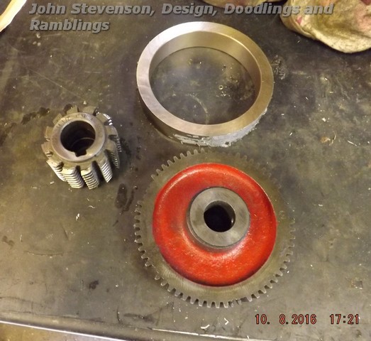

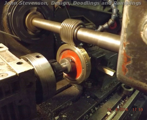

    OK had a bit of time tonight but fast forward a bit as I was driving home afterwards I realised why this is a helical gear. The drive is take from the feed rod by a sliding worm that can select either sliding or surfacing feeds, so the helical is the angle of the worm, Duh !

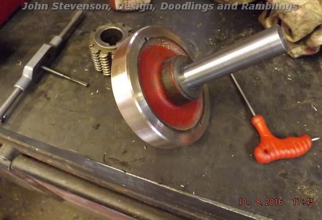

    First start pic, nothing different from the other day other than I have found a bronze ring that will fit.
    One thing I have done is tapped a hole in the gear so I can fix it to a mandrel, the screw can be discarded afterwards.
    Gear turned down and ring pressed and loctited on and a couple of tapped drive screws fitted for added safety.

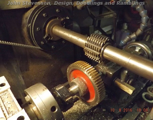

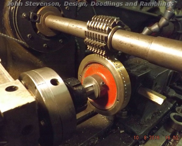

    Blank mounted on the hobber, head set over to 2 degrees and bed set over to the lead angle of the hob. Just touching on the blank at this point so I can zero the knee and apply 0.135" depth of tooth cut.
    Better shot of the hob in relation to the blank, just needs the feed adding and we are ready to go.

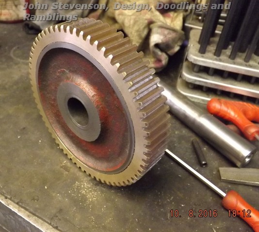

      Gear cut, as it was bronze it cut really easy and it was possible to do the gear in one pass, eight minutes start to stop.
      Gear all cleaned up and finished, need to drop it back Friday as he's not there tomorrow and go skip diving

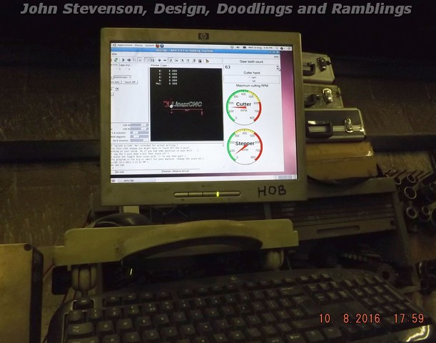

          Jerry,
          It's actually a Victoria U2 thinly disguised as a gear hobber.
          Encoder runs off the spindle to count revs, that's fed into Linux CNC which then spits out pulses for the stepper driven dividing head.
          It used to run off a dedicated black box but it started playing up and Linux makes a fantastic job.
          Screen shot of the controller.
          Standard Linux but with some files changed. I must give credit to Andy Pugh in the UK who did this on his mill and posted the results on You tube and also Dave Caroline who lves near me who actually set this up.

                  Universal table aligned to the hob angle will give you straight gear tooth. You still have to set the dividing head over to generate the helical/angled gear tooth when feeding the table over to cut the full width on the blank.
