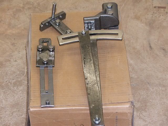

            Here's one of the original pictures.
              I have made one that used a spring as described. I had to loosen the gib on the cross slide in order to make it work. I didn't like that. It did work more or less, but the cross slide was not as stable as I want. I recently made a thread about mine called "Taper attachment for manual lathe".
              http://bbs.homeshopmachinist.net/thr...r-Manual-Lathe

                    I've use a few designs on different lathes, and currently have a homebuilt based on a factory Atlas commercial style. I use it once in a while, especially for shallow tapers (taper pins, mandrels, taper press fit) and tapered threads. The ones that have worked best just use a solid hardened bar and gibs. Round bar or rectangular doesn't matter much as long as it is rigid enough and the drawbar guides keep it straight.
                    The roller units I have used (2 different makes, American was one and the other was a retrofit and I don't know who made it) were ok, but required obsessive cleaning to keep chips and coolant out, or the rollers would skip or jam and slide. The shielding never seemed to do as good as one would like.
                    I could see using a spring on the slack side to remove clearance and, maybe, eliminate backlash, but since they can be used wither 'push' or 'pull', one direction is going to have lower rigidity.

                        A few years ago I posted some pictures of my unit on this board which will do tapers or profiles.
                        The concept does not require a spring , but is direction sensitive to follow any profile.
                        http://bbs.homeshopmachinist.net/thr...s-Cutting-Tool
                        Rich
                        See posts # 8,15,and 21
